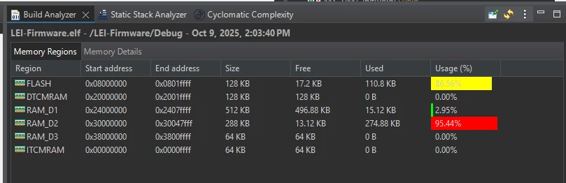

I am working to implement LwIP onto my MCU (STM32H750VBT6TR) with the PHY (DP83825IRMQR).
I got everything set up and was able to do a ping test and create a basic UDP client to send and receive packets (see this thread). This works well on my bare project with just these elements. The issue is that the amount of flash memory taken up by just adding the LwIP peripheral is absurd (it is a combined 110.8 kB out of 128 kB). This leaves little space for the rest of the code this needs to interface with.
Looking at tutorials for LwIP implementations show that only around 77 kB is typically used. I am wondering if anyone can help me track down why so much flash memory is being used in my implementation and if it can be minimized?

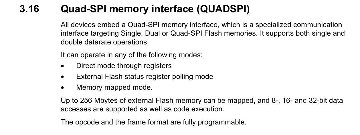

About used flash: what optimizer setting ?  try -O2 .
H750 is intended to be used with external flash, see quad spi ...xip.
So the internal 128KB are for bootloader etc, big programs are in external spi-flash.
CMHenwayAuthor
October 13, 2025
Thanks! The use of external flash does seem to be intended. Good to know going forward.

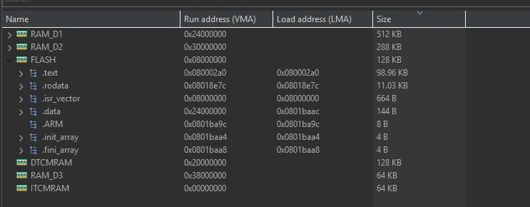

BTW, you can check what's eating your flash a little more detailed in the IDE by opening the "text" part under memory details / flash, and you can order that by size.
This can be very interesting!
In my current "big" H733 project by far the biggest "flash-eater" is a UART printf debugging output, so much const char text...
