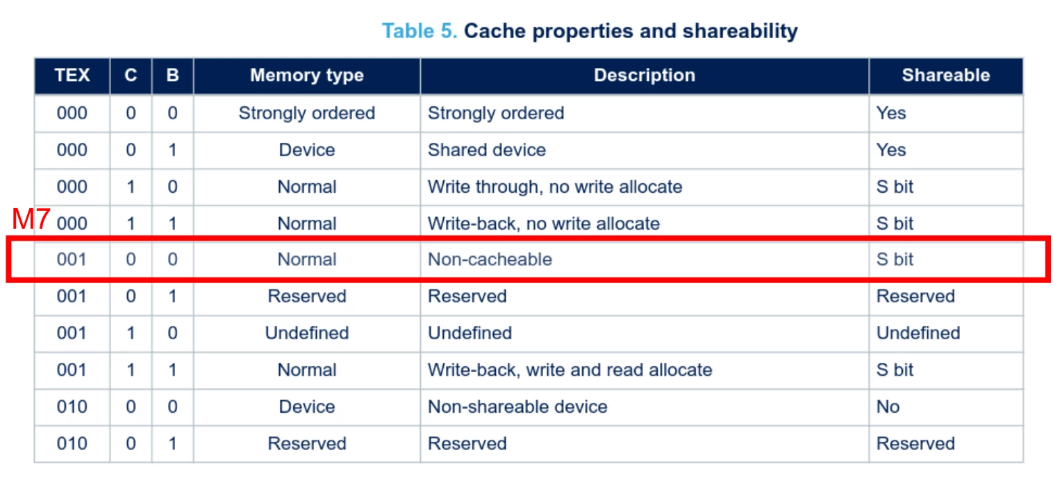

Hello, I created a proprietary board with stm32H757IITx. Unfortunately, I have problems with data transfer between M4 and M7.... I am using SRAM4, configured MPU and used github project:
GitHub - adailtonjn68/STM32H7xx_inter-core_data_share
Unfortunately, but I have a problem all the time in the M7 to upload the data that the M4 is supposed to receive.... When I debug the M4 it works without a problem and the data is placed correctly.
The problem always arises here, the code falls into hard fault:
int put_to_m4(const int *const restrict buffer, const unsigned int size)
/* Try and get lock */
if (atomic_flag_test_and_set(&shared_data.lock1)) <----- here i have HARD_FAULT
 /* Return -1 in case lock is not acquired (used by other core)*/
 return -1;
I tried a clean project with open AMP but it also does not work, I have status = -2005 in M4 in this line:
/* Create an endpoint for rmpsg communication */.
status = OPENAMP_create_endpoint(&rp_endpoint, RPMSG_SERVICE_NAME, RPMSG_ADDR_ANY, rpmsg_recv_callback, NULL);

I was able to replicate the problem.
It was some inconsistency in the MPU configuration.
According to this application note, the F7 and H7 don't support hardware coherency.
It is a bit confusing, but if you want a non-cacheable region for a normal memory type, you need to set the TEX field as 1, cacheable as 0, and bufferable as 0 (see Table 5).
(I didn't understand the last column. If I set the shareable (s) bit, the I get hard fault.)
The code setup for the M7 core is
MPU_InitStruct.Enable = MPU_REGION_ENABLE;
MPU_InitStruct.Number = MPU_REGION_NUMBER1;
MPU_InitStruct.BaseAddress = 0x38000000;
MPU_InitStruct.Size = MPU_REGION_SIZE_64KB;
MPU_InitStruct.SubRegionDisable = 0x0;
MPU_InitStruct.TypeExtField = MPU_TEX_LEVEL1;
MPU_InitStruct.AccessPermission = MPU_REGION_FULL_ACCESS;
MPU_InitStruct.DisableExec = MPU_INSTRUCTION_ACCESS_DISABLE;
MPU_InitStruct.IsShareable = MPU_ACCESS_NOT_SHAREABLE;
MPU_InitStruct.IsCacheable = MPU_ACCESS_NOT_CACHEABLE;
MPU_InitStruct.IsBufferable = MPU_ACCESS_NOT_BUFFERABLE;
The code setup for the M4 core
MPU_InitStruct.Number = MPU_REGION_NUMBER0;
MPU_InitStruct.TypeExtField = MPU_TEX_LEVEL0;
(this is equivalent to be equivalent to the first line in Table 5 (I don't know why. I would love if anyone could explain).
For both cores, I disabled instruction access, but it didn't seem to matter. That makes sense because we are using the memory region only for reading and writing.
Edit: I can set the M4 core memory region to shareable with no problem (it worked, but I don't know why).

Hey, I confirm, now the data transfer works properly! I also tested without configuring the MPU and the data exchange also worked fine.
Your MPU configuration is working correctly. I completely don't know why this is happening.... I will try to test Open AMP to see if it also works with the given configuration!
