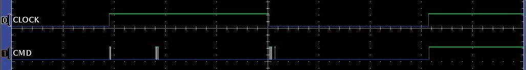

Another noteworthy fact, when we first tried the evaluation board, the demo with the screen remaining "black" (but we could see that the screen was backlit)
Tests:
I tried several sd cards greater than 8 giga.
The power supply is made with the 220V - 5V power supply
I also tried with the power supply via the ST-link.
If I remove the SD card, the result is the same (same timeout error)
The power supply to the card is indeed 2.9V. Tested on SD port and TP9 pinout.
Could you tell me if this is a configuration problem? where Hardware?

For information, I think I found the error.
The clock frequency at initialization is 400 Khz.
However, the frequency for the CMD line is 500 Mhz.
I think the frequency of the CMD line should also be 400 Khz.
But how to change this frequency for the CMD line?
Tteva.1
Tteva.1Author
Dec 4, 2020 2:45 PM UTC
Solution found, TranceiverPresent been on SDMMC_TRANSCEIVER_NOT_PRESENT
Set now at SDMMC_TRANSCEIVER_PRESENT
