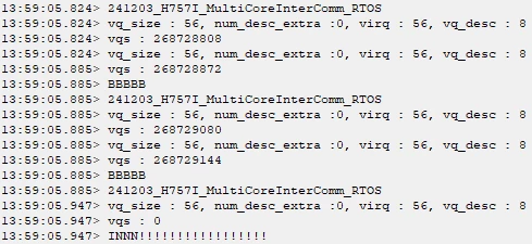

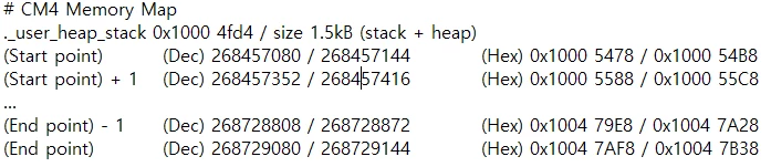

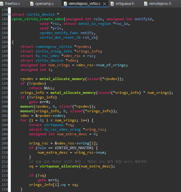

I checked that the error is a exception "err1" under the function "rproc_virtio_create_vdev" in the remoteproc_vrtio.c file. it was caused by the saturation of the memory "._user_heap_stack". Please refers to debugging results and the memory map.
How can I resolve this error?
Is it because I didn't add memory flush logic?
Task ICP(Inter Core Processing) in RTOS handles communication between CM7 and CM4.
the task that is applied HSEM synchronization repeatedly runs from the functions "MAILBOX_Init" and "MX_OPENAMP_Init" to the function "OPENAMP_DeInit".

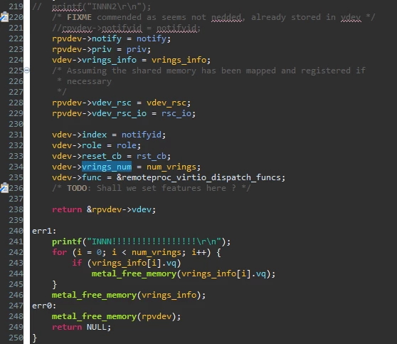

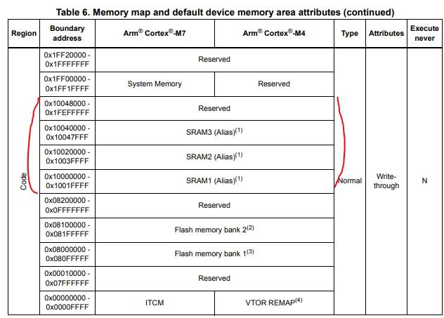

# PICTURE1. The err1 under the function "rproc_virtio_create_vdev" in the remoteproc_virtio.c file

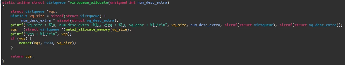

+) The function "virtqueue_allocate" codes
+) The function "metal_free_memory" codes

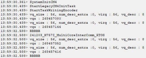

# PICTURE2. The debugging results
1)  Hexadecimal conversion
2) Test end point
3) Test start point
# PICTURE3. STM32H757 referece manual (RM0399)

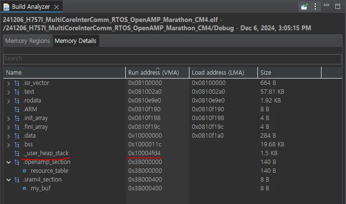

# PICTURE4. STM32CubeIDE build analyzer results

I solved the issue.
The cause of that was the repetitive calls of the functions in an infinite loop during RTOS Scheduling, and I was wrong, so I modified the functions to be called only once during RTOS Scheduling.
I previously thought the memory was freed by the calls to functions like "MAILBOX_Init" and "OPENAMP_DeInit".
