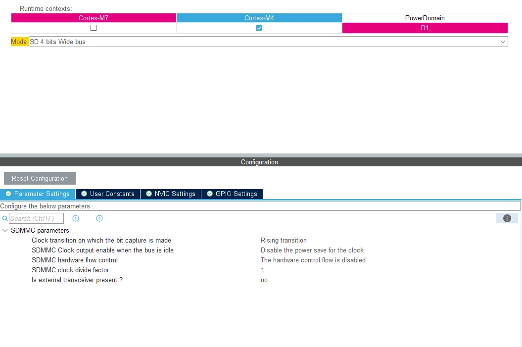

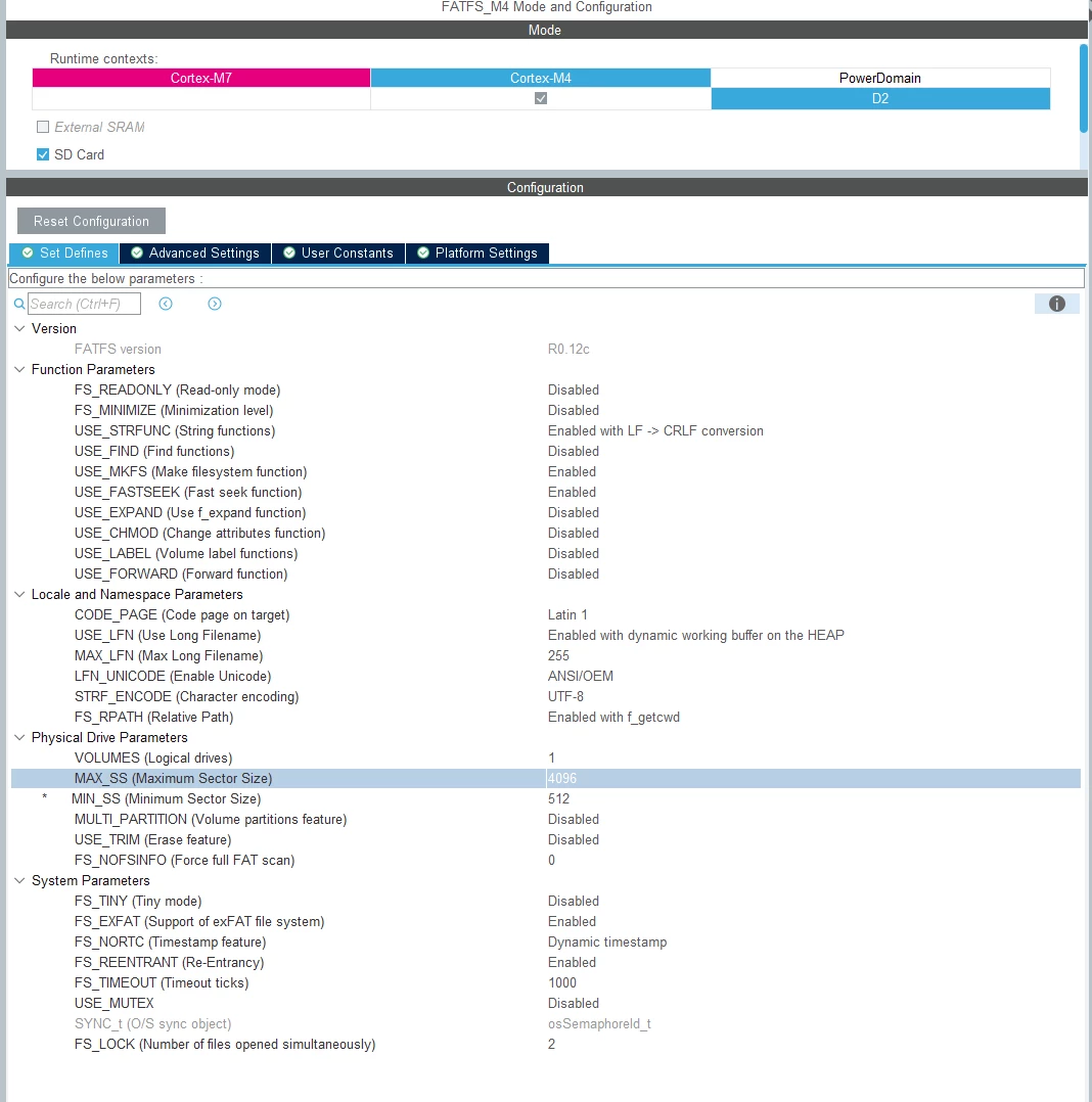

I am attaching below the main configuration details of SDMMC and FatFs from STM32Cube (let me know if you need more detail):
  • SDMMC clock: 2MHz (but i tested also with 25,50,100 MHz)
  • SDMMC bus width:SD  4-bit bus
  • FatFs:
Any guidance or suggestions would be greatly appreciated! Thank you in advance.
