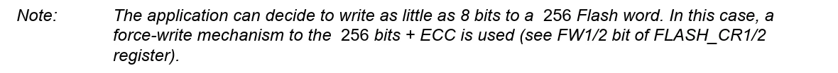

why not reading in the rm ?
here from H743/H750 manual:
Dec 19, 2023 2:18 PM UTC
Due to the presence and nature of the ECC bits, you cannot write less than the full flash page.
Some other chip families do not have the ECC bits and thus do not have this limitation. That is the reason other programming types are in the HAL library.

@AScha.3, reading rm399 and others documents about H7 family I understood that reading/writing even a single byte in a flash word was possible... limitations well explained by @TDK  wasn't reported in so clear form.
