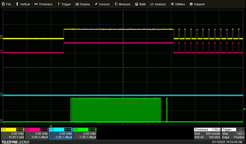

I stripped down and migrated my main application to the NUCLEO-H753ZI to provide a minimal firmware example. The code is available on github: https://github.com/NoyzZimmi/STM32H7_MSC_CDC
The issue is reproducible with the NUCLEO, meaning that as soon as I add the MSC to the project / composite class, the USB device fails to enumerate and the SD card isn't mounted properly.
Yellow / red: Activate / Deactivate signals of CDC and MSC
Green: Read activity of MSC read function:

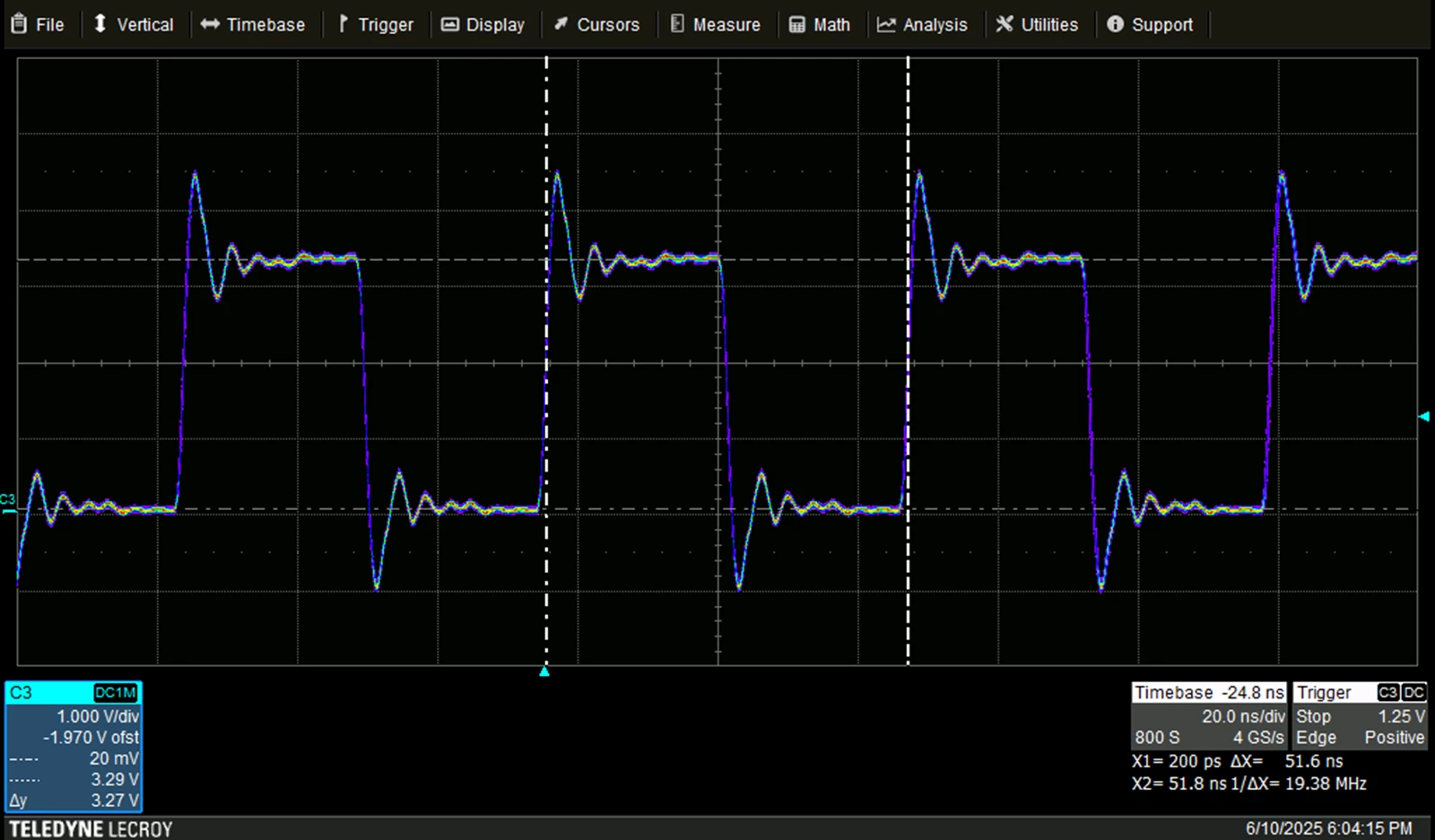

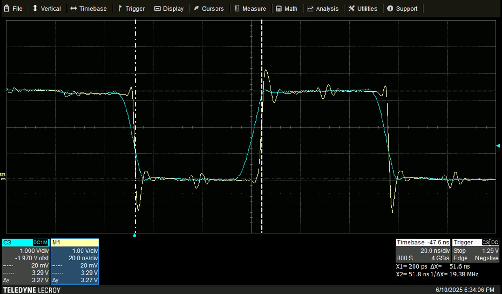

Furthermore, I checked signal integrity and timings of the SD card interface and everything seems to be in order:
SDMMC clock is configure to 192Mhz (PLL1Q from 4MHz) and with the CLKDIV of 5 it results in a 19.3MHz CLK:
Overshoots can be reduced by GPIO speed from "Very high" to "High" / "medium", but it should already be fine for all three speeds. SDMMC CMD gpio speed - very high and low speeds:

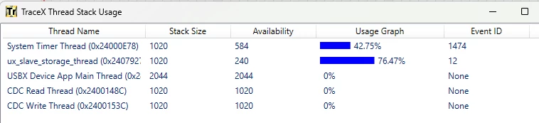

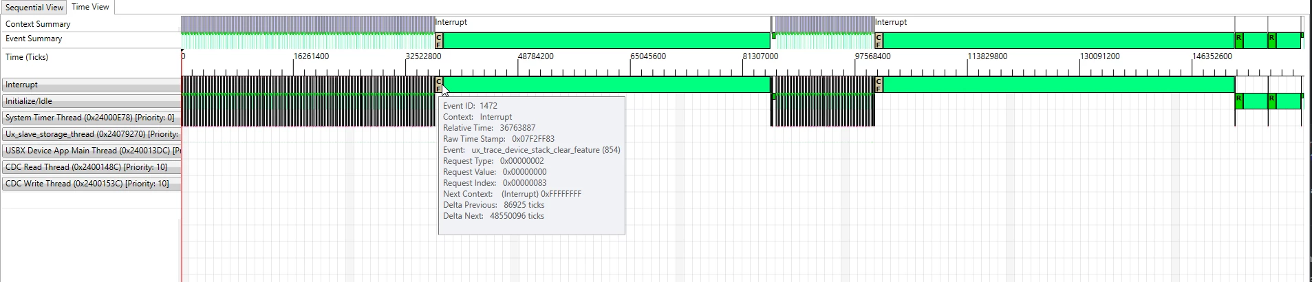

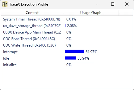

I enabled TraceX for more indepth debugging. It seems that shortly before the USB gets deactivated, the MCU hangs twice in an Interrupt calling ux_trace_device_stack_clear_feature function:DZimm9_1-1749656484370.png
Execution profile confirms this:
And stack usage seems to be fine as well:
