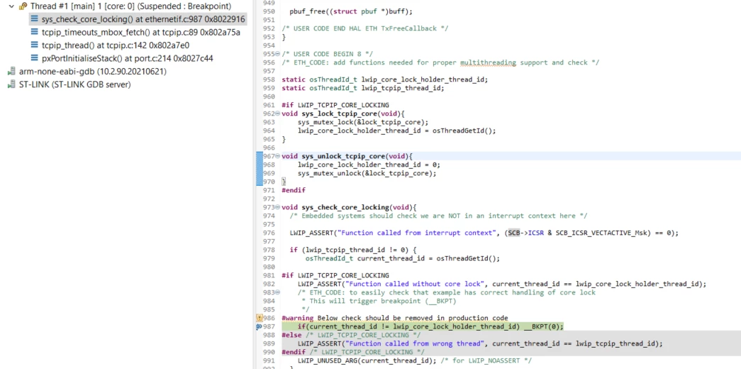

trying to get a setup with stm32h753 running FreeRTOS and LwIP. One attempt in this journey was to take the example: How to create project for STM32H7 with Ethernet an... - STMicroelectronics Community
Using the example code, I see one issue with the core lock - if the breakpoint in ethernetif.c line 987 is enabled I see the code suspends in places one would not expect it to suspend such as:
If I disable the breakpoint, ping works ok.
However even with this example the code quite often (if not always) gets stuck to Ethernet output, it seems that a packet comes down to ethernet low_level_output function, but never gets out to the cable. Suspecting it is a DMA issue, but had no luck locating the issue yet. Any ideas?
Thanks!

When the BKPT hits, what is the thread id?
Is DCACHE enabled? Are you using a concrete example project from the CubeH7 package or the "hotspot" repo, or rolling your own by following the how-to article?

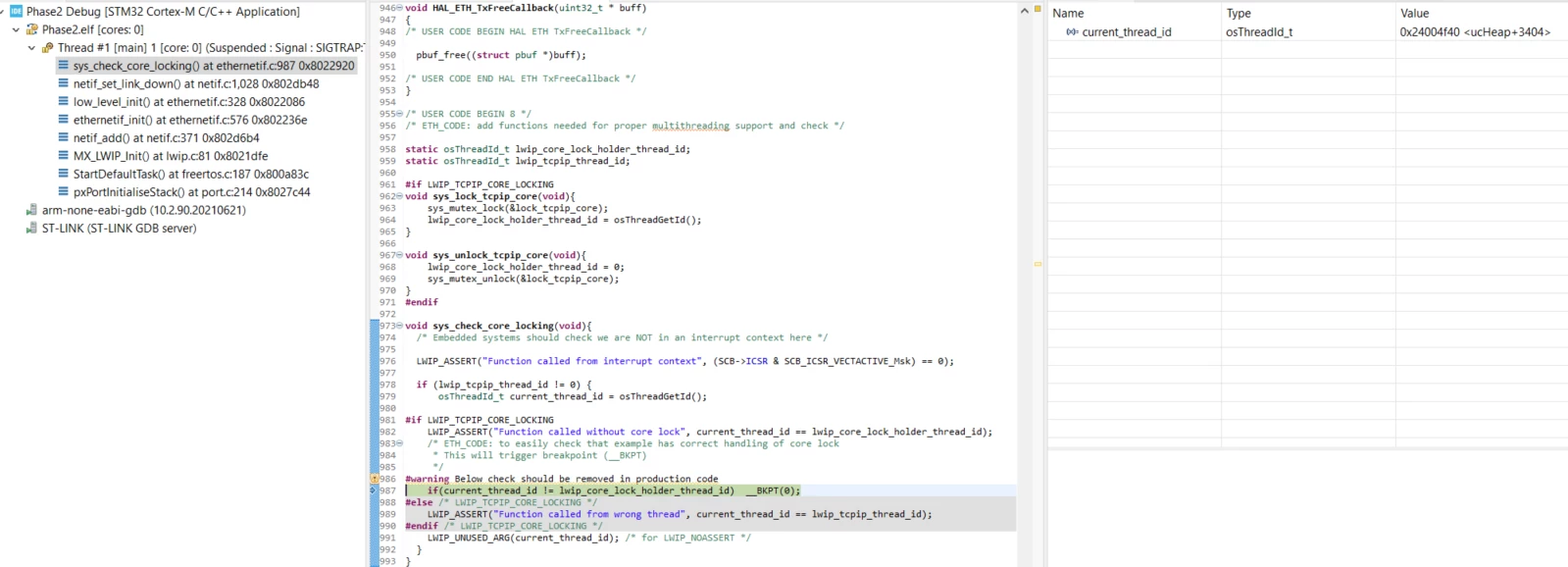

for the thread ID, see below.
The code is based on a copy from the "hotspot" repo(version 1.2). But on top of that is the httpd server from CubeMX amongst others.
DCACHE is enabled.
Hmm, the call stack shows that netif_set_link_down()  expects to be called under the LwIP "core lock". ... I'm not sure whether this function actually requires the lock, but lets assume it does. So acquire the lock in your low_level_init() and other places around calls to netif_set_link_down, netif_set_link_up.
>DCACHE is enabled.
Don't enable DCACHE for debugging. This won't completely remove the cache related issues but should make debugging easier on bring-up stage.
