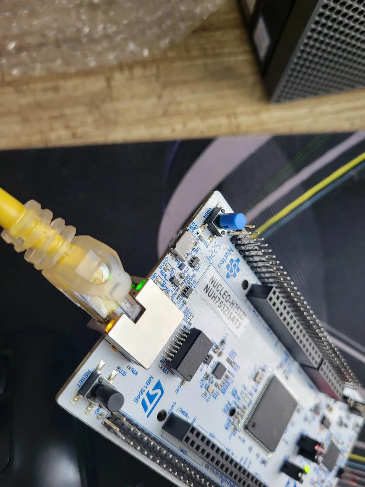

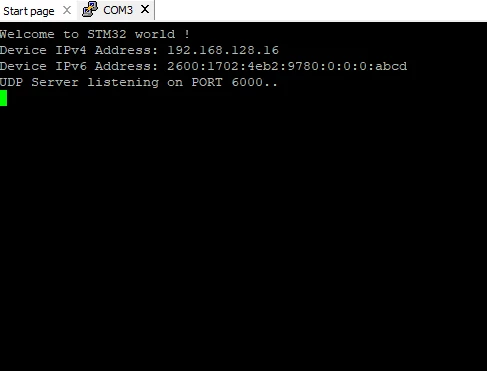

EmaticAuthor
Jun 12, 2025 10:42 AM UTC
Hi @Andrew Neil , @STackPointer64 ,@mƎALLEm
We have checked on your all procedure to enable the Ethernet in the STM32H753ZIT6 NUCLEO-H753ZI (Development Board) with your reference, but the model and type is different(as per your reference).
Carefully we have checked all the settings, But still its not working, we have attached our working files and serial Output. Seeking your support in this matter.

STackPointer64Best answer
Jun 12, 2025 1:54 PM UTC
Hello @Ematic,
It appears you changed the preemption priority but forgot to enable the ethernet interrupt itself.
Best regards,
To improve visibility of answered topics, please click 'Accept as Solution' on the reply that resolved your issue or answered your question.
Vangelis Fortounas
Jun 12, 2025 8:25 PM UTC
Hello . The memory  region  for rxbuffers 0x30000100 is not configured in MPU
Also the tx descriptors 0x30000060 region  is not configured in MPU
Put Tx descriptors to 0x30000000 and configure the MPU for that  region
