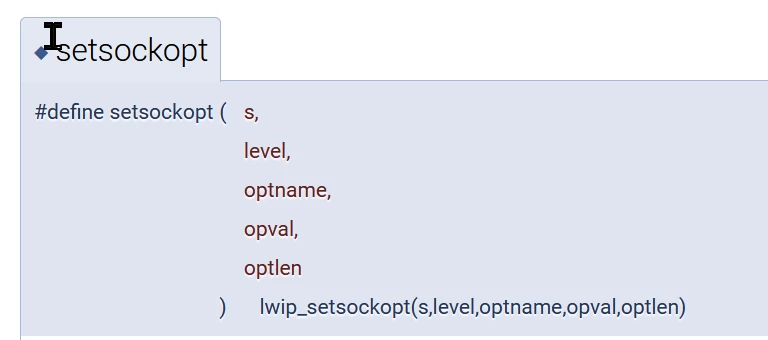

I have attempted to build a system with ethernet capability.
I added the ethernet peripheral, LwIP compiled it without any errors, but the ethernet does not work.  The router it is connected to does not "see" the MAC address and fails to assign an IP address. I have DHCP enabled.
I bolted Adam Berlinger's code into one of my projects
Adams Ethernet
and that worked fine, with DHCP but the I cannot get the latest CubeMX build to work.
I have used the same board and cable that I used with Adams ethernet code for the new build so it's not the hardware.
Is the latest CubeMX build supposed to at least connect to a router and allow a ping test or do I have to do something else. The touchGFX code is working fine.

The Wiki content for the socket API is just a regurgitation of the header file for the macro or function. Here is the entry for setsocketopt:
Now I'm guessing that setsockopt sets some options for the socket the application programmer is trying to instantiate. But it doesn't explain that, or what the various macro parameters do and what valid inputs they can be.
I am guessing that s is the socket handle, but what the rest of them are is beyond me. An application Programming Interface needs a lot more than code it needs an explanation of what the function does, when you should use it and what its parameters are.
