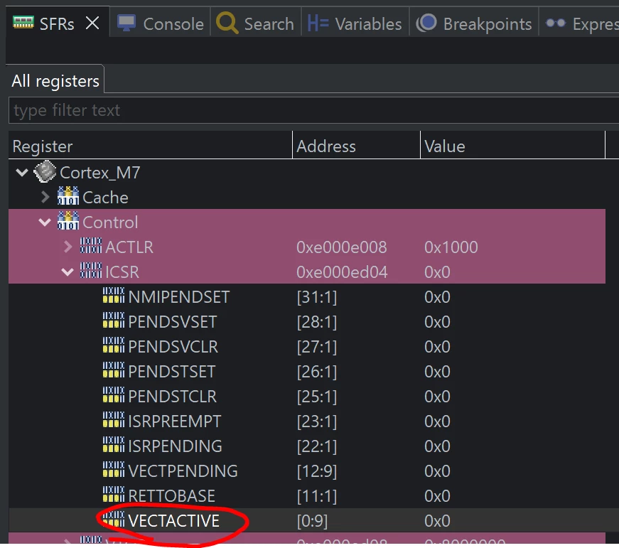

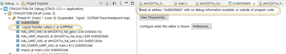

I want to use Uart6 interrupt on STM32H750b DK board, but it doesn't work, so I'm asking here.
Is there anyone used uart on stm32H7xx chip?
I just added the Uart-code using CubeMX and then when I build/start debugging, it stopped during initializing uart6 with following error.
Please give me advice.
FYI, I attached some source codes.
Hope someone reply for this.
Thanks for reading.

Related  https://community.st.com/t5/stm32-mcu-products/bug-the-cubemx-new-version-not-working-usart6-irqhandler/m-p/578006
Vectoring off to random addresses suggest stack corruption, or wrong addressed in the vector table.
August 24, 2023
Okay, so 3 people reporting the same issue, probably is an issue there. At that point in the initialzation, UART6 interrupts aren't even enabled yet.
Look at VECTACTIVE bits to see what interrupt it's in.
