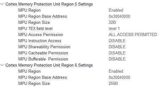

Stm32H750B-DK TouchGFX + FreeRTOS + LWIP Ping not working ?
Hello, im inquiring after thinking about it for a few days.
please help me.
this is my dev environment
CMSIS_V2
TouchGFX designer : 4.22
CubeMX : 6.9.0
CubeIDE : 1.13.1
DevKIT : Stm32H750B-DK
i want to do a ping test on this board
i ran it with reference to this example, but it doesn't work.
(https://github.com/GrzHeller/STM32H750B-DK_TouchGFX_FreeRTOS_MQTT_Example)
i don't know what the problem is.
Please help me
Thank you

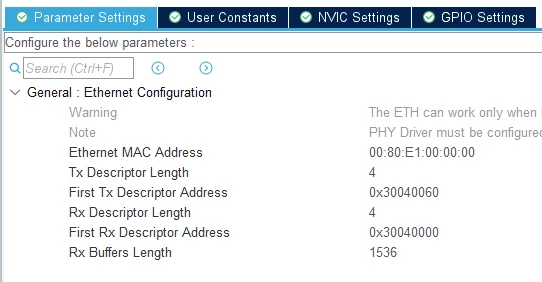

Hello @lhwa .1 ,
I advise you to start by configuring the LWIP. For that I recommend you to follow the steps shared in this FAQ How do I create a project for STM32H7 with Ethernet and LwIP stack working?.
The Goal of this example is to:
  • Configure project in STM32CubeMX for STM32H750-Discovery
  • Configure FreeRTOS and LwIP middlewares correctly
  • Send UDP message periodically (optional)
I hope this help you!
Thank you.

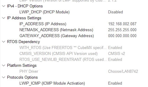

lhwa .1
lhwa .1Author
Aug 10, 2023 6:34 AM UTC
thankyou your reply
i tested thing
ping test OK
UDP Server/Client OK
TCP NG : Assertion "pbuf_free: p->ref > 0" failed at line 753
i don't know why the reason about a week
jumman_JHINGA
Senior III
Aug 10, 2023 7:01 AM UTC
In IP address setting give for PC's address in default getway . And try again
