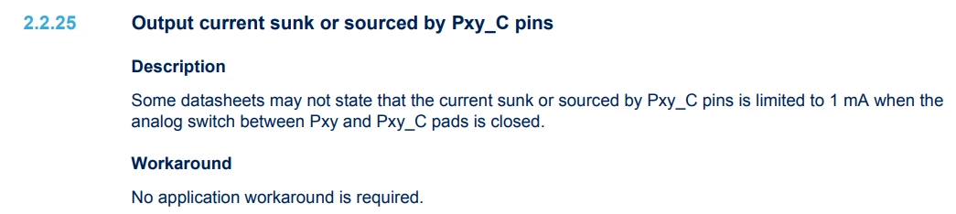

Just to remind you that there is an errata regarding Pxy_C pins:
and OTG_HS_ULPI_DIR alternate function is on PC2_C.

Thanks! I'm aware of the erratum. In this application those two pins are used as inputs so a current limit is not a problem.
It's actually fortuitous that the analogue switch is there because it allowed me to to disconnect OTG_HS_ULPI_DIR temporarily to resolve the deadlock situation.
Should you have any experience as to how this deadlock can arise please let me know. I have now coded up a kluge that detects the deadlock and opens the switch when it arises (happens only once, at startup).
