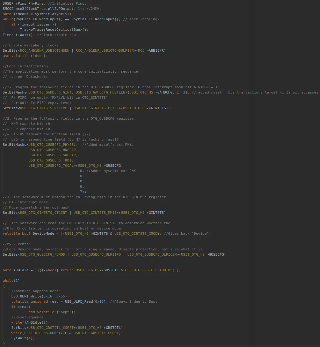

I reimplemented things myself out of desperation. Nothing works. But this is a condensed minimal implementation that should work. I adhered to the Datasheet to the letter. What is wrong?
Its C++ syntax. I hope to those who are unfamiliar with it, that it makes some contextual sense.
WTF. Cant paste my code. The forum does remove my template parameters...
https://pastebin.com/uvR4rv9t
For those who dont trust pastebin :D
Why cant i do the most basic thing. The ULPI bus is completely silent. Not a single line toggles.

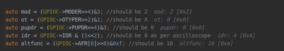

Another update. As frustration grows, more and more basics are questioned.
According to the Datasheet one can read the digital input state of a pin even if it is connected to an alternate function input. Basicall GPIO->IDR always reflects the pin state except in analog mode.
0693W000004Gp30QAC.pngNow, after every register write i just sample the GPIOs and save them in a history.
AND LOOK AT THAT!
The DIR pin is always sampled as HIGH in the IDR-register. (that means the ULPI-Bus is not open for communication)
Well, the truth is, DIR is LOW on the oscilloscope!

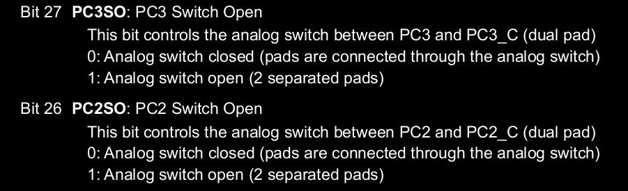

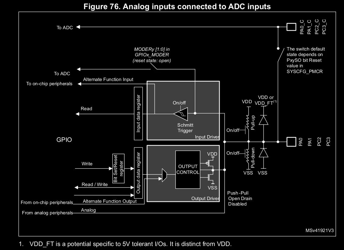

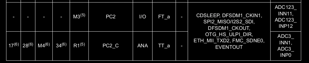

Now, ULPI_DIR is "PC2_C" on my package (H750 in LQFP100) which is somewhat a weird pin.
Lets have a look:
Ok. Whats annotation (6)?
Fair enough. So the switch must be closed. Which register? => SYSCFG_PMCR
Ok... So lets see.
0693W000004GpBwQAK.pngSo... everything should be OK.
WHYYYY is the pin reading HIGH when its LOW??
What could be a reason the analog switches arent working?

Just a double check: reading back the PC2 gpio settings: 0693W000004GpXsQAK.png(everything is ok here, except IDR)

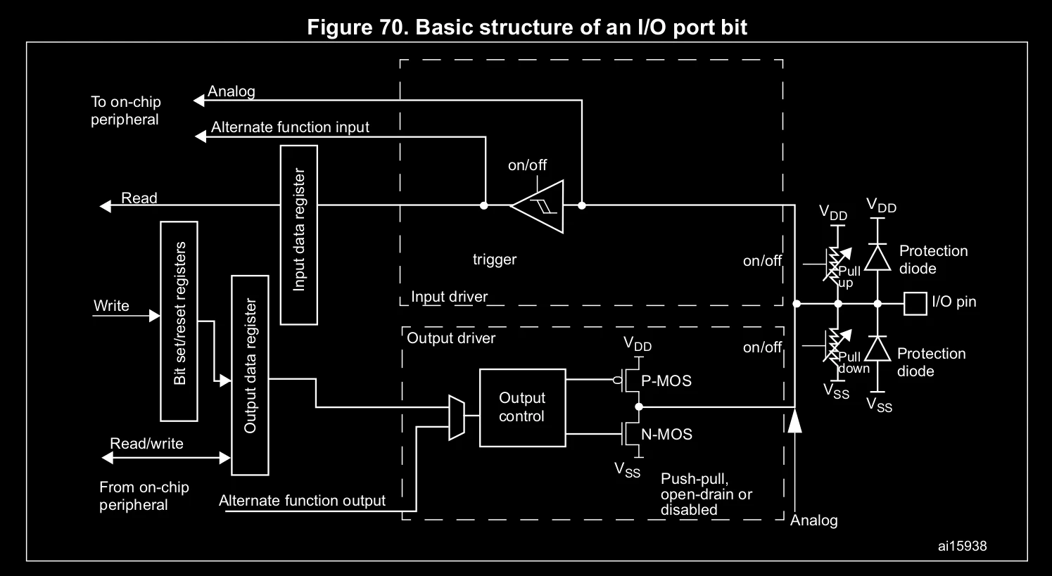

Can anyone explain to me how the ESD-protection on the PCx_C pins work when the device is not powered? (like during soldering!)
0693W000004GtLvQAK.pngI still dont see how any mild ESD could reach into the IDR-register to be honest. I would expect the ADC the only thing to be affected. Yet the digital input is stuck at 1.
Maybe the analog switch is toast. Open on one side and the inward side is fused to VCC.

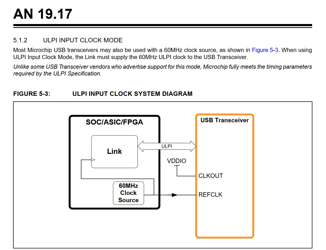

In the USB3300 has version where it can be sourced by 60mhz (reverse direction), How H7 ULPI engine switch to this mode?
