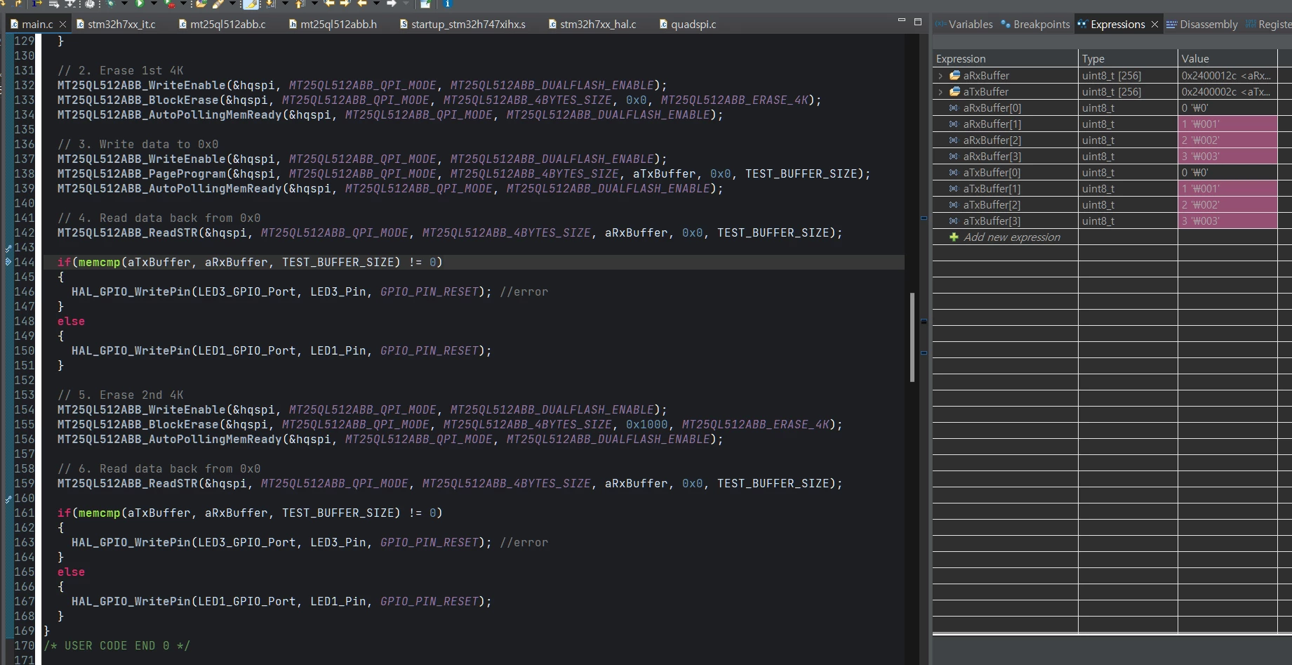

I am reposting this issue because, while debugging, I've determined that the root cause is related to the Erase operation, not the reboot, as I had initially thought in my previous post.
Previous post: https://community.st.com/t5/stm32-mcus-products/stm32h7-qspi-flash-incorrect-data-after-reboot-initial-write/m-p/830635#M284116
Board: STM32H747I-DISCO
Development Environment: STM32CubeIDE 1.19.0
Library: https://github.com/STMicroelectronics/stm32-mt25ql512abb
My code executes in the following sequence:
1. Initialize QSPI and the MT25QL512ABB flash memory.
2. Erase a 4K block starting from address 0x0.
3. Write 256 bytes (aTxBuffer) to address 0x0.
4. Read back the 256 bytes from address 0x0 into aRxBuffer.
5. Compare aTxBuffer and aRxBuffer.
6. Erase a next 4K block starting from address 0x1000 (4096).

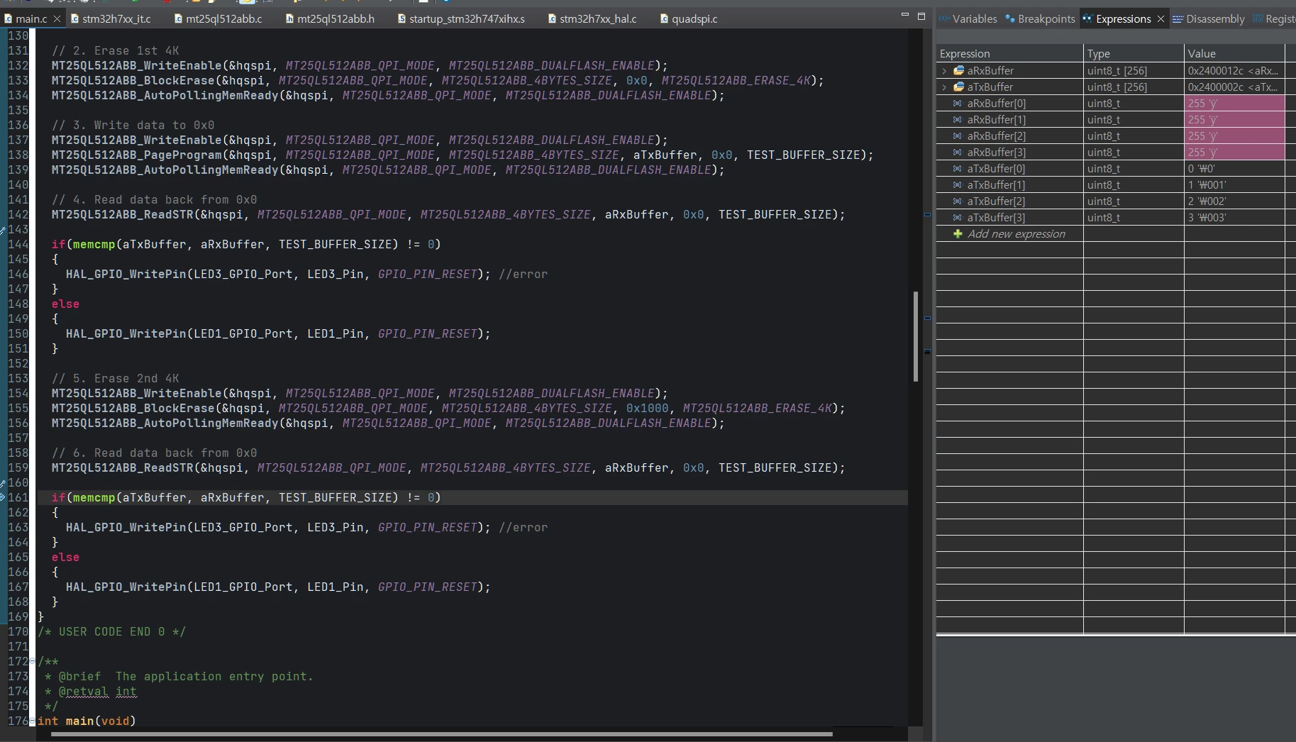

7. Read the 256 bytes from address 0x0 again into aRxBuffer.
8. Compare aTxBuffer and aRxBuffer.
My expectation is that the erase operation in step 6, which targets the 4K block at address 0x1000, should not affect the data previously written at address 0x00.
However, as you can see in the debug screenshot below, the data in aRxBuffer appears to have been erased.
The following links seem to describe cases similar to mine:
https://github.com/leekheee77/kwanhee/issues/1
https://github.com/STMicroelectronics/stm32-external-loader/issues/11
