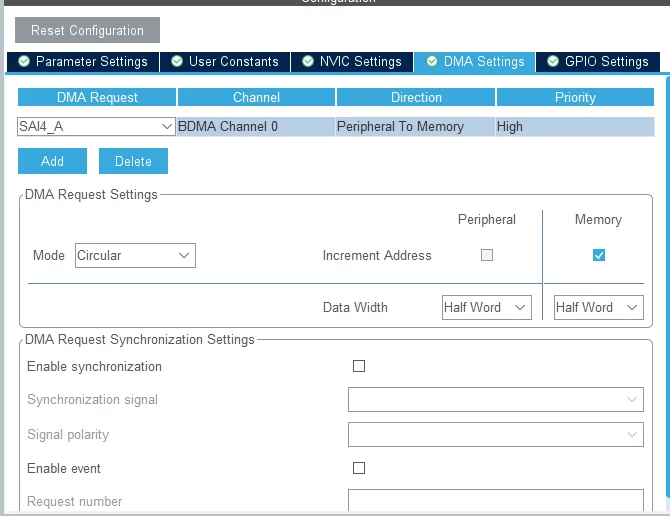

Oct 3, 2025 2:22 PM UTC
Hello @Patryk_Kucia
Could you please share your dma config?
In order to give better visibility on the answered topics, please click on 'Best answer' on the reply which solved your issue or answered your question. Saket_Om
Oct 3, 2025 11:51 PM UTC
and simply
 if (HAL_SAI_Receive_DMA(&hsai_BlockA4, (uint8_t*)PDM_Buffer, PDM_BUF_SIZE) != HAL_OK)
 printf("SAI RX start error!\r\n");
 else
 printf("SAI RX started OK\n");
