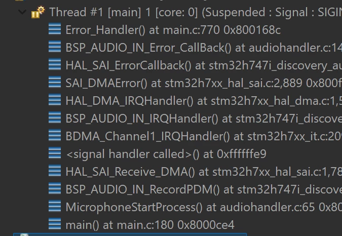

I am trying to fill a buffer from the on-board MEMS microphone using the BSP_AUDIO_IN_RecordPDM() function. However, execution pauses around HAL_SAI_Receive_DMA() and the BSP_AUDIO_IN_IRQHandler() is called. The stack trace is as follows:

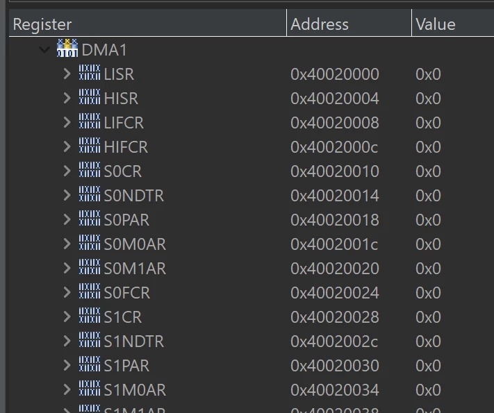

Checking the hdma variable on the debugger, I can see the error code is 1, corresponding (I believe) to a transfer error. I tried looking at the relevant registers with breakpoints, but they were at 0x0 at every point:
I've tried almost everything under the sun. I disabled the D-Cache and allocated all the memory to RAM_D1, I tried allocating my buffer (copied below) to each of RAM_D1, D2, and D3

Where exactly is Error_Handler being called and why? Stack trace is there, should be easy to find out.
miloaAuthor
Jul 11, 2025 3:52 AM UTC
Sorry, I'm not entirely sure I understand. I've only been using the IDE for a few weeks so I may be missing something. Is there something I can print out from inside the Error_Handler to help me debug? The function itself takes in no arguments.
Unless you mean following the stack trace, in which case it looks like the HAL_SAI_Receive_DMA() function is erroring in line 9 in the code below (although it sometimes errors in line 16). After that the stack trace has a "signal handler" at 0xffffffe9 which the IDE is unable to show me, and after that it enters the cascade of interrupt handlers.

Jul 11, 2025 5:11 AM UTC
So keep going down the chain until you see why it was called.
HAL_SAI_Receive_DMA is in the main thread, before the interrupt happened. Error handler was called within the interrupt.
Jul 11, 2025 5:13 AM UTC
It could be that your buffer is located in a place that DMA cannot access.
miloaAuthor
Jul 11, 2025 5:45 AM UTC
That's what I've been thinking, but I don't know what I might be doing wrong in that regard. That's why I posted my linker script and buffer location.

Jul 11, 2025 5:05 PM UTC
Okay! So the issue in this case was that DMA uses SAI4 and not SAI1. After fixing the issue with CubeMX I'm still reaching the error handler but at least it's a different error now: an SAI ErrorCode 2 (underrun)
