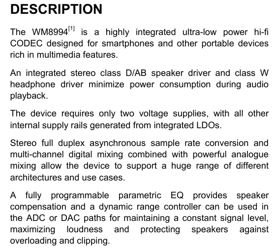

I tried studying the datasheet of the wm8994 but coudn't understand how to make it work, I just understood what it could do. I am not an experienced user so I would like to use some sort of BSP function instead of spending a lot of time trying to learn to configure it.

first some things to think about:
- did you read the WM8994 ds ? or at least, look at it ? It has 359 pages, about 300 or 500 registers (!!OMG!).
- to understand it in a basic way, needs many hours - to more or fully understand it, maybe some 2 or 3 weeks.
- What you want to do with it - really ?
see start of ds :
A lot of programming and understanding of most or all internal modules is needed...
or you want just play a demo, to see: ok, its doing something ?
->  instead of spending a lot of time trying to learn to configure it.
So decision is : you have got it "doing something" , ok, and now play with something else,
OR read and learn , until its doing exactly, what you want - even you might need 2 weeks or more to do this demanding job.

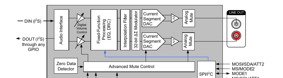

no, i have no example for this. Because (i also want to do some audio things...) i see the codec, look at its data sheet and think: oh no, not for me. And board is not cheap. So i decided to connect to a simple board ("black pill", F411, about 4 $ ) and a "simple" DAC, that has only few registers (to learn: just few hours) and has average good data : PCM5102A .
Then to play a little with DSP , can use a faster cpu (H743 now) and do some calculations (biquad filters, even in double float no problem) and a more complex DAC with little DSP , PCM5122 :

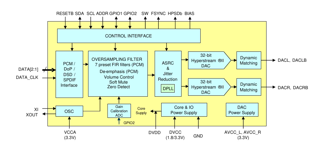

Now its my "audio-player" , plays wav/flac/mp3 (double float precision) from SDcard and USB , with my old (Sony) IR remote control (i just like it), with hi-end quality sound.

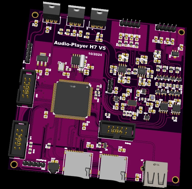

Made a board for my toy:
...and 2x TDA1387 DACs , NOS, to make active speaker system - if  i have motivation to do so. 6ch are here.
And "DSP" is just the 400MHz H743. (And ADCs - it has 16 bit fast ADCs .)
So i would recommend: think first, what you want to do, then puzzle together some parts, that have a useful time-to-learn -> do-what-you-want   relation. Not to waste much time to learn about complex chips - that functions you anyway dont plan to use.
