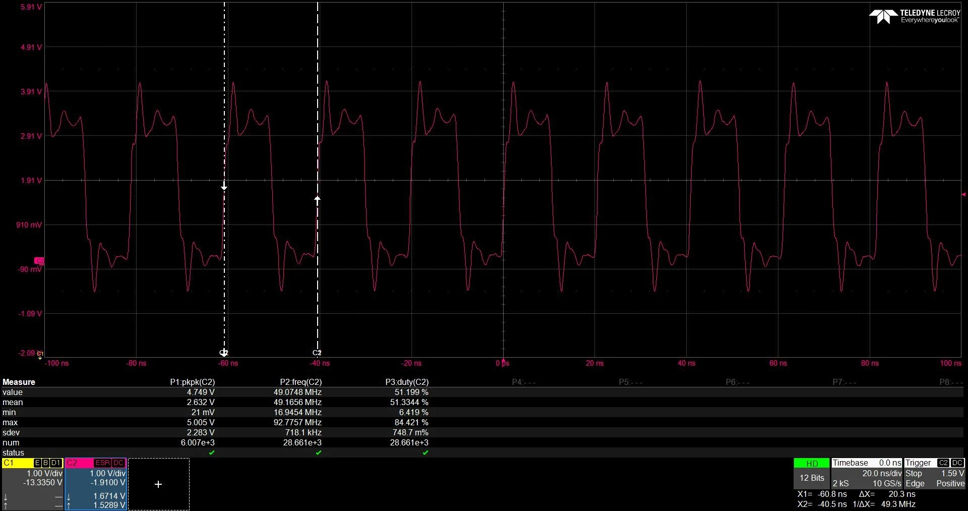

Okay, so I've tried for a while with MCO2 on my STM32H747I-DISCO devboard. The clock is extracted from the microSD connector CN12, but it looks more like an analog clock than a digital one; it is not a square wave, at least. The frequency is set to 49.152 MHz to achieve a sampling frequency of 48 kHz on the adau1361, and maybe the pin connected to the microSD connector doesn't support such high speeds? Or, there might be something fishy with the measurement setup. I don't really know, I have consulted a lot with my team but we can't really seem to find what's the issue with this clock/pin. Do you have any ideas?

The "Maximum output speed" is set to very high in CubeMX, and now I'm measuring directly on the microSD-connector, so only PCBA traces involved (and oscilloscope probe, of course). It is not the most high-tech oscilliscope, just a small Tektronix TDS2024B. I have it in 10x mode, so it should be able to measure up to 200 MHz frequencies.

We have now tried to measure the clock with a Lecroy HDO6104B using av ZS1500 active probe. The duty cycle of the MCO2 is around 61% for a number of different frequencies. We have tried with 49.152 MHz, as we want in the final application, but also with 48 MHz, 30 MHz and 80 MHz. Still, the duty cycle is around 61%, and the edges oscillate, making it look like a square wave with a superimposed sine wave. The measurement setup can not be much better now from our side, so we are left to wonder what might be going wrong with SW/HW?

lukasmaAuthorBest answer
Mar 13, 2024 10:58 AM UTC
Well, turns out that when we configured PLL2 to provide the clock for MCO2, we used dividers which were not even, According to the reference manual, you don't get a duty cycle of 50 % in that case. Switching these to even numbers instead now gives a duty cycle around 51.3 %, which is a great improvement. We would like it to be more smack on 50 %, but maybe it doesn't matter if we can get it to work
AScha.3
Mar 13, 2024 11:06 AM UTC
Ans signal looks ok now ? (no sine wave...?)
lukasmaAuthor
Mar 13, 2024 12:19 PM UTC
I mean, we still have some under-and overshoots:
Between each vertical line is 20 ns. But it doesn't look at all that bad as it did initially.
