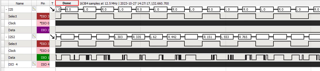

I hooked all the I2S lines to a data logger and the peripheral seems to work.
but whenever I get a new buffer from DMA it is Empty and all set to '0'.

Anyway... so you are not using DBM mode, with double buffer you mean you are using 2 buffers?
Here:
> HAL_I2SEx_TransmitReceive_DMA(&hi2s2, (uint16_t*)&outBuffer[0][0], (uint16_t*)&inBuffer[0][0], AUDIO_BUFFER_U16_STREAMS/4);
DMA always reads & writes to xBuffer[0], it will never ever use xBuffer[1], but in the complete callback pointers are set to xBuffer[1].
You should start with RX buffer all the same values (something recognisable like 0xA5A5, but neither 0 nor 0xFFFF),
then fill your TX buffer with e.g. "i++".
Then, as a start, leave out any other hardware and directly connect I2S data in and out.
For debugging, don't copy anything, just check your RX buffer, which should be equal to TX buffer.
