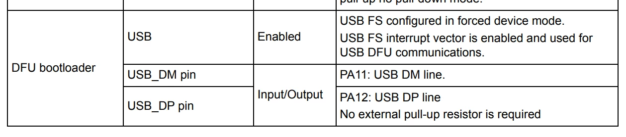

Hello! I have one of the new Arduino Portenta H7's which is fitted with a STM32H747XI. I need to get the board into DFU mode and don't have easy access to the BOOT pin. So I would like to achieve this via software. I tried the ST suggested code, but it doesn't work. I tried boot address 0x1FF09800 (provided in the example code) and address 0x1FF1E7FE (from the data sheet). My understanding is that the Portenta includes custom Arduino bootloader code (which has been selected by tieing the BOOT pin to GND) but the embedded bootloader (DFU mode) should still be present. Any assistance would be greatly appreciated.

Looks like the USB connector on that board is using the HS USB which is not supported by the STM32 bootloader.

Hi TDK, we are working on porting BetaFlight (drone flight control firmware) to the Portenta. BetaFlight Configurator can detect when an attached board is in DFU mode. To double check this I also opened up the STM32CubeProgrammer, and it can't detect any attached boards in DFU mode either. The only way that I can upload code at the moment is via the Arduino bootloader (which uses dfu-util ironically). There is not much debug capability built into the Arduino IDE.

Thanks TDK - you were on the right track. The Portenta can do both HS and FS USB however Arduino devices have a proprietary USB VID/PID. This was the problem. All we needed to do was modify the BetaFlight Configurator source to recognise the VID and PID. I appreciate your assistance and the time spent looking into our problem.
