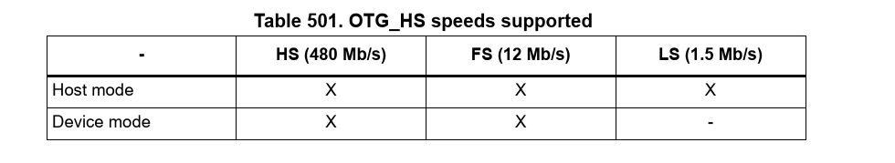

from H747 ds :
I see no LOW SPEED here - so look in rm , H743 here :
To make it clear :  you want H747/HOST -> HUB -> mouse/DEVICE   -- right ?

> Is the STM32H747 hardware capable of LOW SPEED communication?
-- from rm : yes, as host. + > Without HUB, I have succeeded < So you proofed it already.
