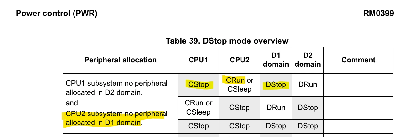

> Is it physically possible for CM4 to continue executing code if the D1 domain is in DStop
Yes, it's physically possible as long as CPU2 doesn't use anything in the D1 domain.
I suggest creating a new project where you only look at this aspect and try getting that to run. It's possible your application is using something else that you're missing.

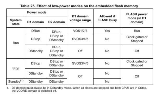

Thanks for the insight. I have a follow-up question regarding the memory architecture:
My CPU2 (CM4) is currently executing code directly from Flash memory (mapped at 0x08100000), while its stack and data are in D2-domain RAM (0x10000000).
Since the Flash memory controller is physically located within the D1 domain, does entering DStop on D1 effectively cut off the Flash clock or power for the entire system?
If so, does this mean that CPU2 (running in D2) is physically blocked from fetching instructions the moment D1 enters DStop, even if the D2 domain itself remains in DRun? I suspect this 'hidden' dependency on the D1 bus matrix is what's causing my CM4 to stall, as it works fine in Sleep mode (where the D1 bus remains active).

Hello @Patryk_Kucia
According to the RM table 59, D3 peripherals can remain clocked in STOP mode if autonomous mode is enabled (LPTIM2AMEN = 1) and its kernel clock source is a low-power clock that remains active in D3Stop, i.e. LSE or LSI.
If LPTIM2 is clocked from PCLK/PLL or AMEN is not set, it will not run in STOP.
