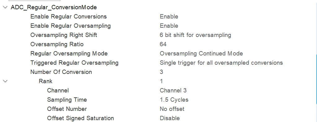

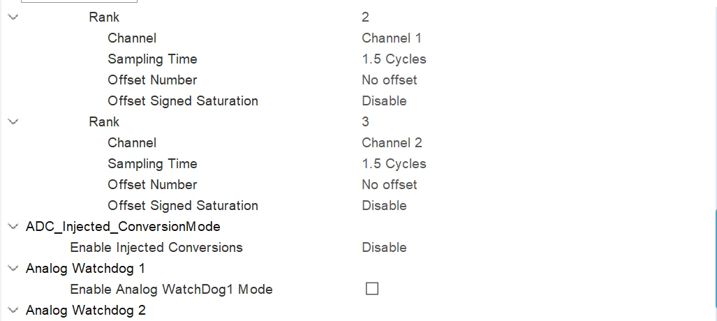

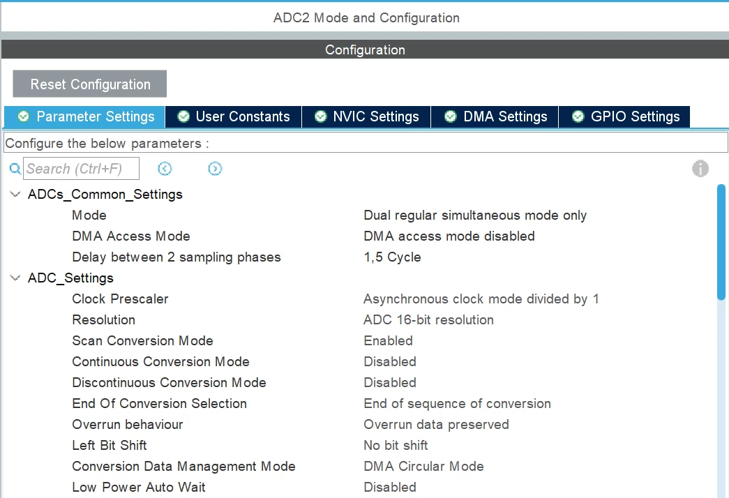

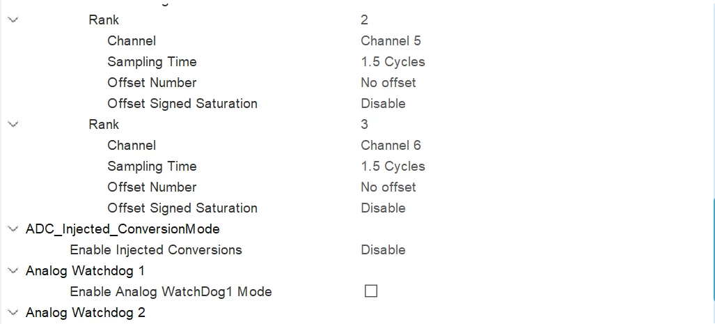

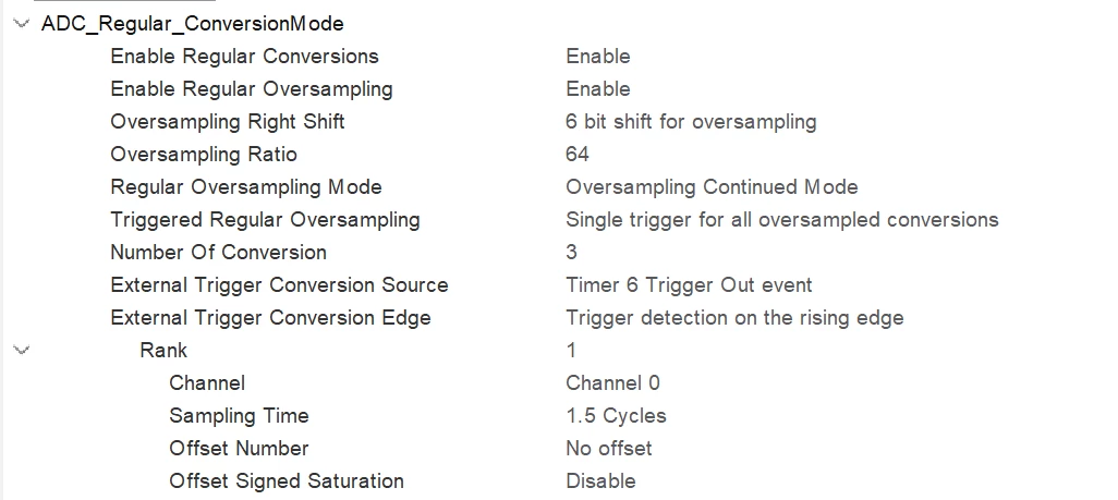

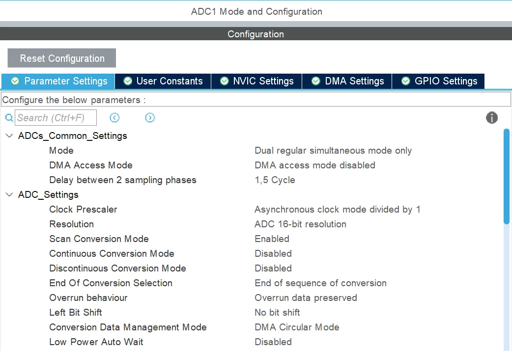

Some other questions:
- in Stm32Cube, is it correct that I have enabled DMA request for adc2 (in DMA settings)? I thought that I shouldn't configure it, because it was already configured in adc1, but if I remove this, I have a error.
- here is my configuration, can you check it please and tell me if it's correct?
- can you explain me please what does the parameter "delay between 2 sampling phases" refer to? How can I calculate this parameter? (And, the same for "Sampling time" in every Rank)
