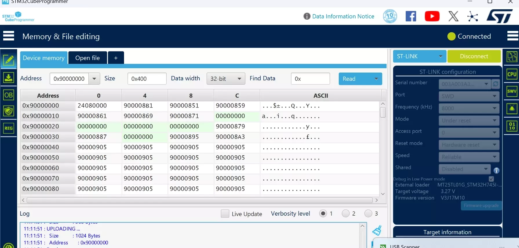

After building the application, I generated the .bin file and programmed it into the QSPI flash using STM32CubeProgrammer.
When I read back the contents from address 0x90000000 using CubeProgrammer, I can see valid data programmed in the flash (screenshot attached).
However, while debugging the bootloader, I observed the following issues:
  • The code enters the HardFault_Handler() before executing JumpToApplication();.
  • The value of JumpToApplication is observed as 0x00000000 in the debugger.
  • As a result, the application is not started from the QSPI flash.
I have attached the bootloader project, application project, and screenshots for reference.

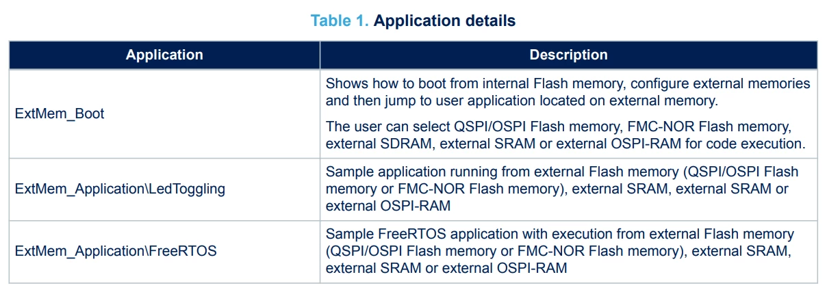

Hello  and welcome to the ST community,
Please refer to the AN5188 "How to execute code from external memory on STM32F7 and STM32H750/H7B0/
H730 MCUs"
You can inspire from what was implemented on STM32H750B-DK board:
1- Boot application located in the internal Flash: https://github.com/STMicroelectronics/STM32CubeH7/tree/master/Projects/STM32H750B-DK/Templates/ExtMem_Boot
2- Any of the examples that are executed in the QSPI:  https://github.com/STMicroelectronics/STM32CubeH7/tree/master/Projects/STM32H750B-DK/Examples
Good luck.
