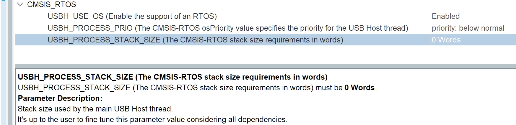

A short investigation showed that the USB HOST process is not started. It is supposed to be started by FreeRTOS, but it fails to start because of zero passed as the stack size for the process. So I manually fixed it in my `usbh_conf.h` file like this: `#define USBH_PROCESS_STACK_SIZE ((uint16_t)512)`. Naturally it worked, we're good. But here's the actual problem:
There's no way to define the stack size in STM32CubeIDE. So any change made with CubeIDE will reset my change to zero, and I must remember to manually fix it to 512.

Anyway, why can't it be set with CubeIDE? It seems like a bug to me, I wonder if anyone knows how to fix this annoyance, so I could safely save changes in IOC file not having to worry about invalid stack size for the process. Maybe is there a way to manually edit the IOC file to make it work properly?

Oopsie. There is a gear icon when the value is clicked, I can choose "No check" and then I can enter whatever, like 512.
