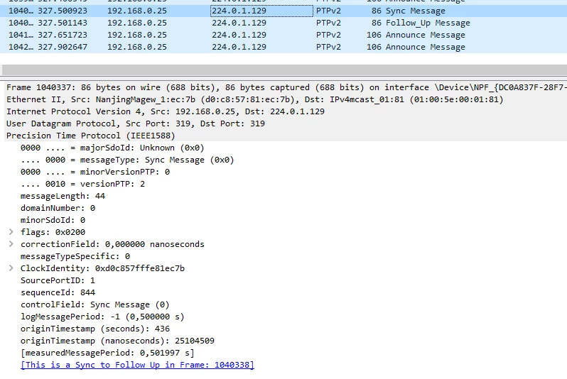

I’m busy with the implementation of PTP support inside my project.
I choose the STM32H745, because there is PTP support in hardware, with a nice offload function. After reading and try to understand the manual I create this code:

What I try to do: I want to implement PTP Slave device that reacts on PTP message and try to synchronize the time inside the hardware counter. Without any software interaction, hardware offload.
When I sniff with Wireshark nothing happens, there is no communication send from the STM to the PTP master. What do I wrong?
My PTP master, is a off the shelve box specially made for PTP. The SYNC and Follow up data packets are sending though the network.
My ClockIdentity: 0xd0c857fffe81ec79
SourcePortID: 0x0001

Are you 100% sure that your external PTP master is using PTP over ethernet, not the UDP version?
JDWBE
JDWBEAuthor
Jun 25, 2025 8:54 AM UTC
See here a screen capture from WireShark. For me it looks like PTP over ethernet. image.png
LCE
Principal III
Jun 25, 2025 9:53 AM UTC
No.
Problem found, check the Wireshark message: it is UDP.
Check if you can change the master to pure PTP over ethernet (Ethernet Type of an Ethernet-encapsulated PTP message is 0x88F7).

Yes, those packets look like PTP over UDP.
If you want to go through Ethernet, I guess you should add MAC receive filters for PTP multicast address as well (check out "Packet filtering control register (ETH_MACPFR)" on the reference manual).

I'm not sure if either I am or you are absolutely wrong here:
the H7's PTP offload hardware works ONLY with PTP over ethernet, no IP address multicast filtering will help if the master uses PTP with UDP. The "pure ethernet" packets don't even have any IP addresses, using MAC addresses only. Although it is using a MAC-multicast address (0x011B 1900 0000).
Check RM0468, chapter 63.5.4, last part is about PTP offload.
Maybe you should grab another H7 board and use its offload function and make it PTP master.
Which makes sense, as the H7 PTP offload only supports one-step timestamp syncing (no FOLLOW-UP messages from master), so the master must make sure that its SYNC messages include its correct hardware timestamp.
Which is given when using H7 PTP offload as master - or so I hope...
