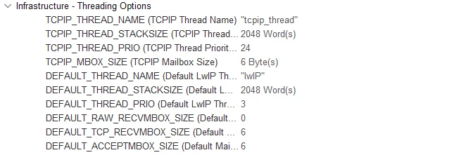

/* Stack size of the interface thread */
#define INTERFACE_THREAD_STACK_SIZE ( 350 )
I changed 350 with 1024
I’m checking the watermarks with vTaskList and this is the result:
defaultTask X 24 53 1
EthLink R 16 194 6
IDLE R 0 489 2
tcpip_thread B 24 287 4
EthIf B 48 147 5
Tmr Svc B 2 982 3
EthIf task has (147*4) bytes never used, it means that it used at least once (1024-(147*4)) which is more than 350 initially provided by the library.
The default value of tcpip stack set by default in cubemx is too tiny as well, 1024 bytes is the minimum required to run but it is totally used since the beginning with no safety  margin, 2048 is strongly suggested (like set in the example).
With this configuration it seems that I’m stable to obtain ip from dhcp, ping the board and keep the connection up without memory leaks or corrupted data issues.
PS: a mention about the need to modify both .ld files for m4 and m7 could be appreciated in the readme

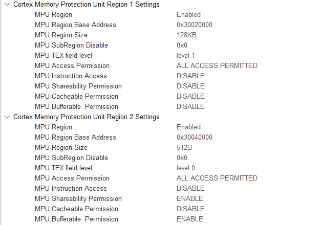

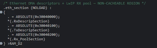

Hi, I did not ran any example since I’m not working on demo board but on a custom board with STM32H745. I only looked at them in order to cherry pick the ioc file. If you have the same situation I suggest you to work on your own project by using stm32bubemx, after enabling eth, mpu, freertos and lwip set them as follows.
Set mpu like this:

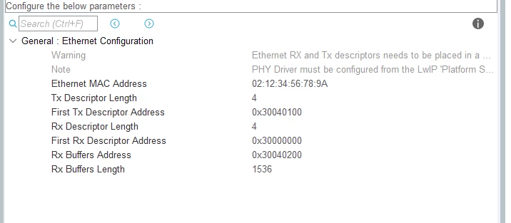

set eth buffer addresses according to mpu section 2:

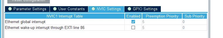

and enable interrupt:
set lwip heap according to mpu section 1:
and stacks:

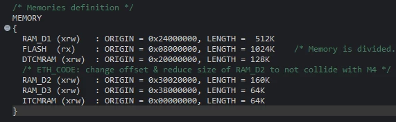

and finally define sections in linker file
set freertos min stack size:
If you are running lwip on m7 this will be you m7 memory map:
and this for M4:
Generate code and fix enthernetif.c for stack size and garbage lines like we said.

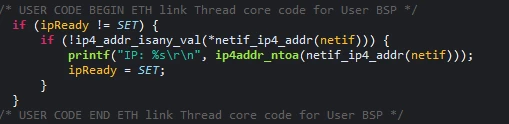

Print ip address once at the end of ethernet_link_thread:
I cannot guarantee that this is the perfect configuation but it works for me with minimal changes to default configuration in cubemx.
Hope it will be helpful for you.
