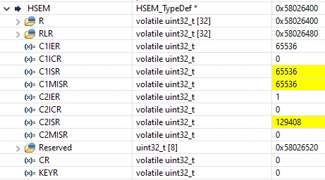

STM32H745: Freeing a semaphore does not trigger an interrupt
There is very little information on the internet, let alone any example that I could look at. My problem is that freeing a semaphore does not trigger an interrupt. I need this feature to allow one core to notify the other in case a certain condition arises in software during runtime.
The code is simple:
#define TR_EVENT 16
// Clear all interrupts
HSEM->C1ICR = 0xFFFFFFFF;
// Reset interrupt status register
HSEM->C1ISR = 0;
// Reset interrupt mask register
HSEM->C1MISR = 0;
// Turn on interrupt for TR_EVENT
HSEM->C1IER |= (1 << TR_EVENT);
 // Lock semaphore TR_EVENT
SEM_SET(TR_EVENT);
// Unlock semaphore TR_EVENT
// ---> should trigger the interrupt:
SEM_RESET(TR_EVENT, SEM_CM4);

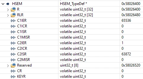

Before entering line 16, the content of the HSEM registers look as follows:
After line 16, the content is this:
So it appears the resetting of the corresponding semaphore properly sets the interrupt registers, but an actual interrupt does not occur. Anyone have some experience with semaphore interrupts? Who could steer me in the right direction to find out what's missing?

Just minutes after posting, I found the problem. I forgot to enable the interrupt. D'oh!
NVIC_SetPriority(HSEM1_IRQn, 6);
NVIC_EnableIRQ(HSEM1_IRQn);
