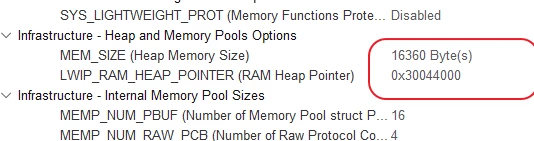

STM32H745 and Ethernet
I have read quite a few threads about ethernet on the H7, along with several internet posts. Part of me wonders if I should even try... But I am.
I've followed this guide:
https://community.st.com/s/article/How-to-create-project-for-STM32H7-with-Ethernet-and-LwIP-stack-working?t=1679361727348
As well as this guide:
https://github.com/AnielShri/STM32H745_Ethernet/blob/master/Documentation/lwip_nortos.md

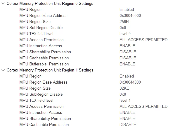

They are similar, with some slight differences with the MPU cache settings.
For me, the first post results in a hard fault. But with the second, I am able to boot.
While I would eventually like to get to RTOS, at the moment I'm just trying to implement this using LWIP.
My first test is just basic ICMP - which doesn't work. That is, until I comment out this line:
SCB_EnableDCache();
So, of course, that implies something with the data cache, and memory locations.
So, my settings looks like these:
0693W00000aJMqQQAW.pngLWIP settings:
I've added the following to the linker script:
 /* Modification start */
 .lwip_sec (NOLOAD) : {
 . = ABSOLUTE(0x30040000);
 *(.RxDecripSection)
 . = ABSOLUTE(0x30040060);
 *(.TxDecripSection)
 . = ABSOLUTE(0x30040200);
 *(.RxArraySection)
 } >RAM_D2
Sometimes, I get this error upon each ICMP packet that is received:
 Assertion "pbuf_free: p->ref > 0" failed at line 753 in ../Middlewares/Third_Party/LwIP/src/core/pbuf.c
Again, it goes away when I disable the dcache. I'm not sure what else to try. I must have something not quite right. Thanks.

Pavel A.
Mar 21, 2023 2:39 AM UTC
>SCB_EnableDCache();
Of course it does. But this is a bit complicated. So keep reading the forum posts, especially by @Piranha​  who made several valuable digests.
Also look at most recent ST examples for H7 here.
Hold your impulse to generate projects with CubeMX/IDE until you have at least one ready example (for some eval board) working more or less.
Also note that recently ST ​is moving from LwIP and FreeRTOS to Microsoft's offering: AzureRTOS (ThreadX, NetX etc.), if this sounds good to you, research that direction.

Not so helpful, but... I never enabled the caches in the first place.
I'm using H723 / H735 (they have different memory layout and restrictions compared to the H74x) with lwIP, works great.

In CubeMX, you cannot enable LWIP without the caches. Doesn't mean much, but there it is. If all else fails I will continue down that path. I really wanted to get them working in conjunction.

One more reason to use CubeMX only as a starting point... (I did so too, and then threw out almost everything, including the ETH HAL drivers).

https://community.st.com/s/question/0D53W00001Z9K9TSAV/maintaining-cpu-data-cache-coherence-for-dma-buffers
https://community.st.com/s/question/0D50X0000BOtfhnSQB/how-to-make-ethernet-and-lwip-working-on-stm32
