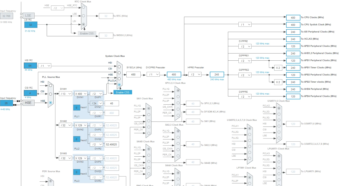

STM32H743XI SDMMC1 SD Card - HAL_SD_ERROR_UNSUPPORTED_FEATURE
I'm currently facing an issue with a basic project to setup the SDMMC1 peripheral where the function HAL_SD_Init() fails. The issue is happening inside HAL_SD_Init(), in SD_PowerON(), where it always returns HAL_SD_ERROR_UNSUPPORTED_FEATURE.
I'm using a custom board with the STM32H743XI MCU with an external clock of 26MHz and the STM32CubeH7_FW_H7_V1.11.0 package.
Please find below a picture of the STM32CubeMX Clock configuration:
0693W00000Y8g0PQAR.png0693W00000Y8g0jQAB.pngHere is the code that setup the clock:

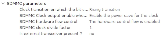

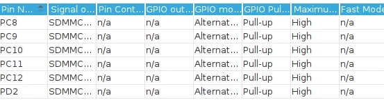

AScha.3
Jan 20, 2023 12:21 PM UTC
on my H743 board here i use this setting :
0693W00000Y8lOgQAJ.png0693W00000Y8lP0QAJ.pngtry this settings. there never was a startup problem; just "very high" port speed may not work, try medium or high.
