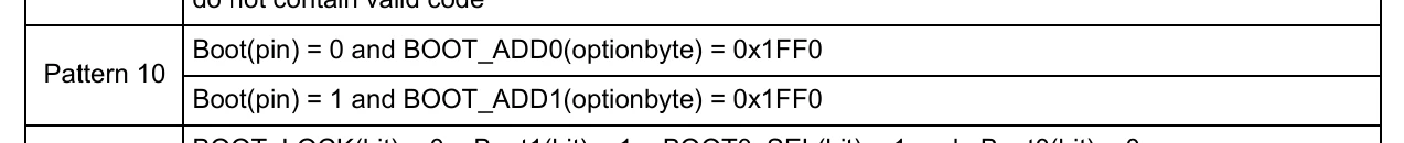

If you hold reset, does the device disappear? And it re-appears when you release reset?
The reasons the chips boots into the bootloader are listed in AN2606. There are a multitude of ways to boot directly into the flash. You need to configure one of those. These involve a combination of option bits and the BOOT0/BOOT1 pins.

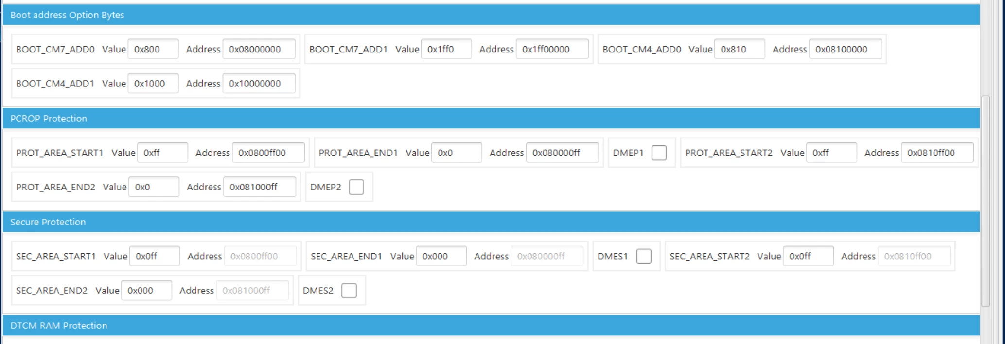

Here are my address Option Bytes. I have never configured them before, but they show that BOOT_CM7_ADD0 is 0x0800 the start of Flash memory and ADD1 is 0x1ff0 the start of System Memory. Does this mean my system is fine and my chip is not confusing DFU and Flash modes?

January 25, 2026
It sounds like you are not controlling the BOOT pin as you think. This could be due to a test setup error, or a bad solder connection, or something else.
Here are the possible ways for it to get into the bootloader:
It's also possible your user program jumps to the bootloader if that's something you have programmed into it.
