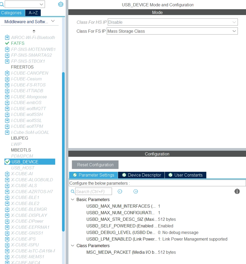

As per the video, I've added a couple lines to the usbd_storage_if.c file :

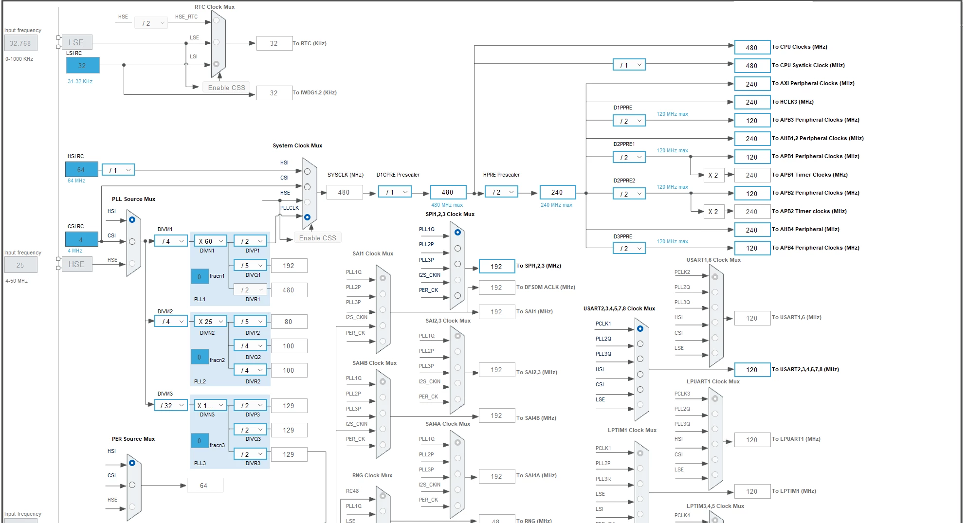

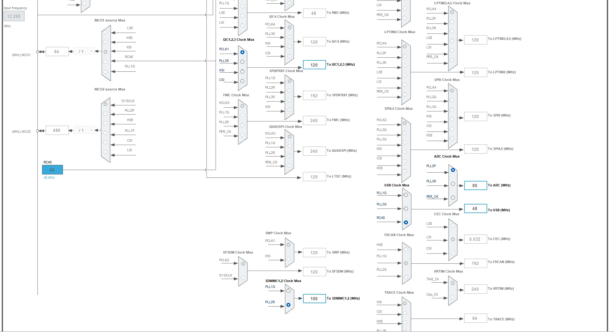

Clock configuration seems ok to me, I've tried the same settings as in the video and the ones attached in the files below and the issue remains. Please note that I am using HSI instead of an external oscillator. Here are the other important info not shown in the screenshots :

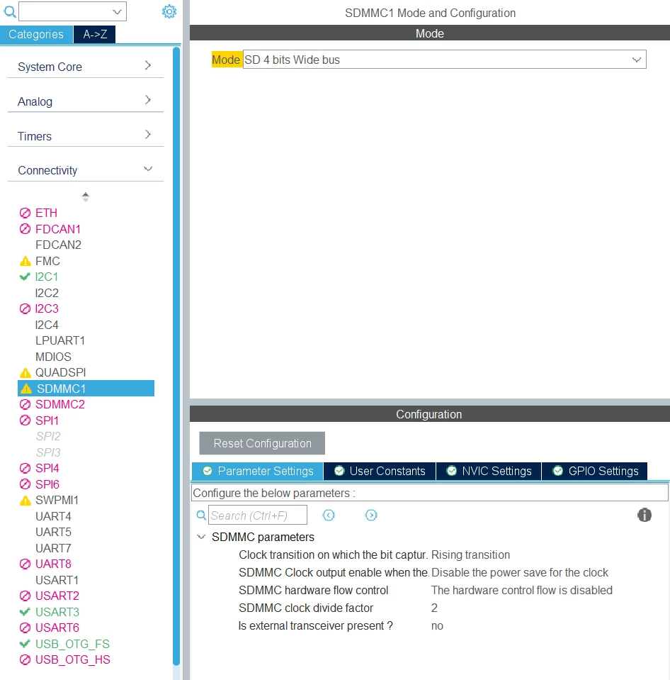

SDMMC1 :
- Tried either Very High and Low output speed with no luck.
- Global interrupt are enabled.

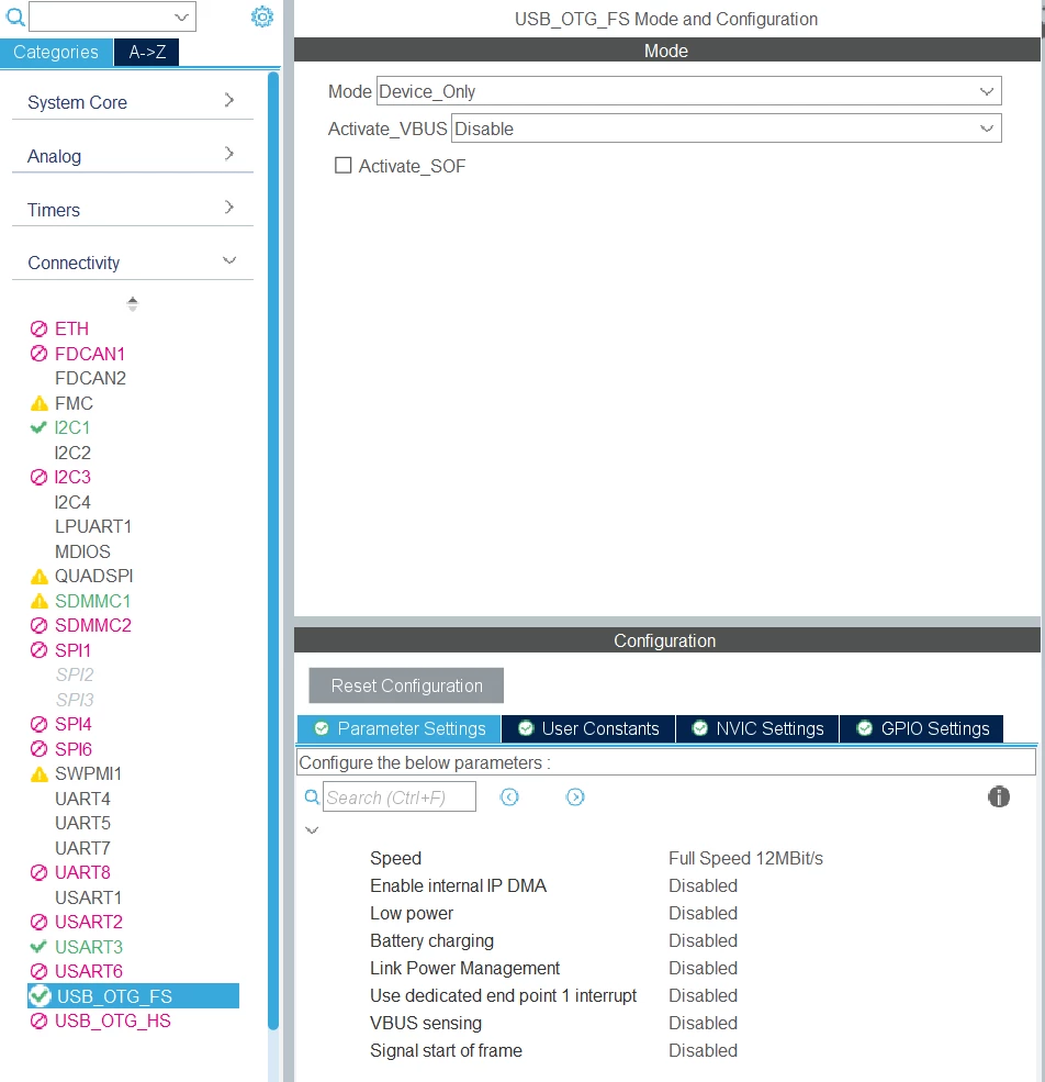

USB_OTG_FS :
- All interrupts enabled
USB_DEVICE :
- Device descriptor has not been changed

Best answer by AScha.3
try first. sdmmc with 1 bit mode , no DMA; pin setting : all pins pullups ON, speed medium ;
clock for sdmmc 50MHz (i use 100M , internal divider 1 ( so is /2  = 50M );
And board ? custom ? (Line length to sdmmc is critical, less than 50mm is fine )

AScha.3
AScha.3Best answer
May 14, 2025
RPuccioAuthor
May 14, 2025
Hi AScha.3 and thank you very much for your reply !
Now trying SDMMC1 in "SD 1 bit" mode, all pins pullups on, speed medium, clock 50 MHz by setting the clock divider factor to 1. DMA is already disabled in my test project now, because I enabled the bare minimum which are USB_DEVICE in mass storage class, SDMMC1 and USB_OTG_FS in device-only mode with no internal IP DMA.
Board is custom indeed. Max line length to SDMMC is about 43mm, and I don't expect to run the SD card at high speed as it's just for transferring wave files between the project and a computer.
Now, I do get the SD card to show after a short time (maybe 10 seconds ?).
Trying a couple things, in order :
- Switching to SDMMC 4 bit mode, and a divider of 4 (clock frequency 12.5 MHz) -> it works.
- Switching to SDMMC 4 bit mode, and a divider of 2 (clock frquency 25MHz) -> it does not work.
- Switching off the pull-up/pull-down on the STM32 configuration, as I already have them in hardware, and going back to a divider of 4 -> it works.
At that point, oscilloscope is now scanning the clock and sure enough, the signal has a lot of overshoot (25% !)
- Switching to a very high output speed : still works, no change to overshoot.
I use 22 ohm resistors on every pin, placed as close as possible to the STM32. TVS are placed as close as possible to the SD card connector, so I guess my issue is hardware based.
- Switching to a low output speed : overshoot looks way better on the scope (3%), but I still can't increase the clock frequency above 12.5MHz.
Well, at least, I know how picky the STM32 and the SD card can be when it comes to signal quality. I'll try a couple other hardware modifications (no TVS, higher series resistors) and see if it lets me increase the clock frequency, but as long as I can transfer data easily, I'm good !
Still, I don't understand how it is possible that FastFS can read and write data at higher frequencies, but the USB mass storage needs lower speed. I may open topics related to that project later, but I'm not stuck anymore for now on. Thank you very much AScha.3 for helping me making that thing work !
AScha.3
May 14, 2025
Ok,
so with real pullups , no need to switch on the internal (but also no bad.).
No good idea for USB ! (maybe also SD card) Use HSE crystal or oscillator as "master" clock.
USB only working on other than a crystal reference, if explicitly stated in rm.
pin speed for USB : try all....low to high; (depens on your added damping resitors an trace impedance, what best).
RPuccioAuthor
May 14, 2025
AScha.3 : unfortunately, I didn't design the board with an external oscillator input. I could still hack one on top of it though but soldering gets harder ! The USB in the clock configuration runs out of the internal RC 48MHz oscillator, which is surely not as precise as a dedicated crystal run through a PLL. I have tried a couple configuration and settled on a medium speed with 100R series resistors for now, but couldn't get the clock faster than 12.5MHz.
FBL : thanks for the reply ! That may explain why I can increase the speed within FatFS, but not when using the USB mass storage class. I'll be more careful when I build the final product, as I'm working on a prototype board right now.
