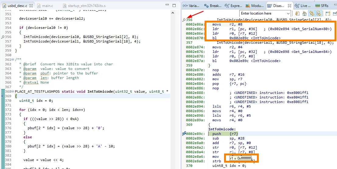

I'm experiencing a hard fault error during USB CDC enumeration and can't track its source.
The failure occurs in the file usbd_desc.c, when the functon Get_SerialNum() calls a subroutine IntToUnicode() which shall convert an uint32 into its string representation.
I could track down that the calling function Get_SerialNum() provides a valid memory address at 0x24000164 where the string result shall be placed, but in case of that error the called function IntToUnicode() gets 0xFFFFFFFF as destination address which finally causes the hard fault. Screenshots are attached.
To reproduce the issue you can download the provided STM32CubeIDE project to the STM32H743 and place a breakpoint in stm32h7xx_it.c in line 74 (the hard fault handler code).

  1. I've modified the linker script so that the functions mentioned above are placed at the specific flash location where I encountered the error for the first time. It is position 0x2E844 (see line 106 of the .ld file). If that position is changed by 4 bytes up or down the error does not occur. Later on I found out that the flash region could start at any position which is dividible by 8 without causing the error. The question remains: Why does this error occur as the STM32H743 should be able to execute code aligned to 32 bits although the AXI bus is 64 bits wide?
  2. You can place a breakpoint anywhere in the subroutine IntToUnicode without affecting the error condition. If you place the breakpoint at the very first assembly code you are able to see the wrong destination address 0xFFFFFFFF in register r1. But DON'T place a breakpoint in the calling function Get_SerialNum and try to do single stepping as then the error does not occur. Again I have no clue why!

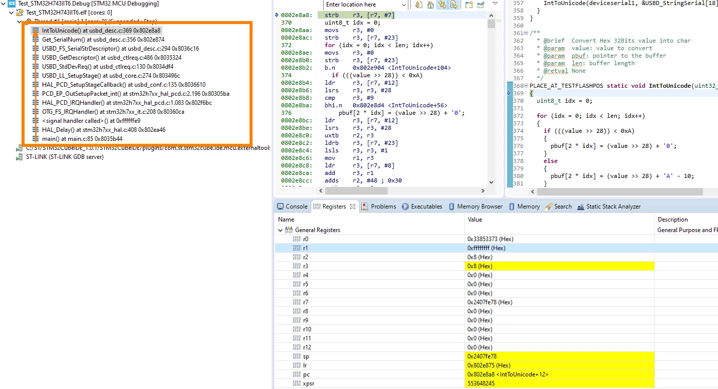

(3) The screenshot provided shows the call stack which proves the same as the lr register. Basically the IntToUnicode function is called from Get_SerialNum as expected. I think it's worth to mention that all these functions are running in the USB IRQ handler context by the HAL and LL USB layers. As ARM doesn't support re-entrant IRQs it should not be possible to have another IRQ influence here. Or is this assumption wrong?
(4) Related to (1) I checked the flash peripheral registers, but no error has been detected there. The SR1 & SR2 registers as well as the ECC_FA1R & ECC_FA2R are all zero.
Screenshot: Call-Tree and registers shortly before the hard fault:
