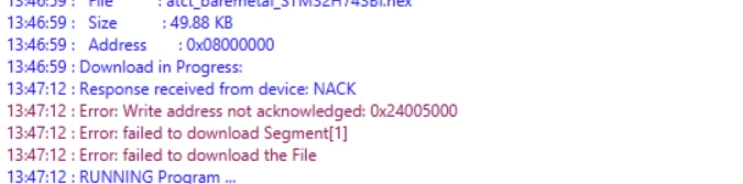

STM32H743BI bootloader saves data to RAM.
hi
my software programmer is trying to set DMA on RAM, he passed the start address of the DMA RAM buffer from 0x20000000 to 0x20004100 and we got the error in the attached picture.
he said that the LINKER of the CODE demands to define the pointers to the RAM, to prevent from other compiling commands takes that RAM area.
the bootloader still refuses to write to RAM also in address 0x20004100 which was supposed to be accessible.
please advice
According to the application note AN2606 (Cf. Table 113), the bootloader is using 20 Kbyte starting from address 0x24000000. Thus
you can only start programming at address 0x24005000 to 0x2407FFFF. We can also find at table 174 the only accessible memory addresses:
 0x20004100 - 0x2001FFFF
0x24005000 - 0x2407FFFF

This is the answer for my last question:
Dear Zvi Sade,
Below case has been updated.
Case#: 00179761
Subject: STM32H743BIT6 BOOT LOADER fail to communicate via USART1
Description:
Here is my response:
I am using RAM_D1 because USART DMA can only write data to this section.
If i use SWD/JLINK, i successfully writes to RAM_D1 with no issues.
Why bootloader fail to write something to RAM_D1 section?

What exactly are you looking for here?
The SWD doesn't access via code execution
The System Loader runs from ROM, and it uses some of the SRAM for it's own purposes.
Do a disassembly, and determine the threshold conditions for the memory check.
Why are you pushing data into RAM here anyway? You're writing a hex file describing 0x08000000, if STM32 Programmer is reporting correctly, can't you just unpack what you need into RAM? Why is it described in the .HEX ?
ZSade.1
ZSade.1Author
Jun 7, 2023 7:37 AM UTC
in STM32H7, in order to user the DMA for USARTS, the DMA is controlling the D1/D2 memory regions.
therefor I need to locate the DMA rx buffers in these regions (2400000).
(https://community.st.com/s/article/FAQ-DMA-is-not-working-on-STM32H7-devices)
I am not forcing anything to be written during flash.
there is no problem with flashing the hex file as is via SWD. just the bootloader has problems "flashing" ROM...
my linker script section is:
MEMORY
DTCMRAM (xrw)   : ORIGIN = 0x20000000, LENGTH = 128K
RAM_D1 (xrw)   : ORIGIN = 0x24005000, LENGTH = 492K
RAM_D2 (xrw)   : ORIGIN = 0x30000000, LENGTH = 288K
RAM_D3 (xrw)   : ORIGIN = 0x38000000, LENGTH = 64K
ITCMRAM (xrw)   : ORIGIN = 0x00000000, LENGTH = 64K
FLASH (rx)   : ORIGIN = 0x8000000, LENGTH = 2048K
 /* User_heap_stack section, used to check that there is enough RAM left */
 ._user_heap_stack :
  . = ALIGN(8);
  PROVIDE ( end = . );
  PROVIDE ( _end = . );
  . = . + _Min_Heap_Size;
  . = . + _Min_Stack_Size;
  . = ALIGN(8);
 } >DTCMRAM
 .d1_block :
  . = ALIGN(4);
  *(.d1_block)     /* .data sections */
 } >RAM_D1
 .d2_block :
  . = ALIGN(4);
  _sd2_block = .;    /* create a global symbol at data start */
  . = ALIGN(4);
  *(.d2_block)     /* .data sections */
  _ed2_block = .;    /* define a global symbol at data end */
 } >RAM_D3
  /* Ethernet Modification start */
 .lwip_sec (NOLOAD) :
  . = ABSOLUTE(0x30040000);
  *(.RxDecripSection)
  . = ABSOLUTE(0x30040060);
  *(.TxDecripSection)
  . = ABSOLUTE(0x30040200);
  *(.RxArraySection)
 } >RAM_D2
 /* Ethernet Modification end */
and the code is located at D1:
uint8_t __attribute__ ((section (".d1_block"), aligned (4))) protocol_rx_buffer[128];
Pavel A.
Pavel A.Best answer
Jun 7, 2023 11:48 AM UTC
Try to make .d1_block (NOLOAD) just as .lwip_sec.
Will this solve the loading problem?
If yes : your script still does not look right because the initialized data section is missing.
Take a link script from any Cube-generated example (even without ethernet) and compare.
ZSade.1
ZSade.1Author
Jun 7, 2023 12:39 PM UTC
the "NOLOAD" did the job
thanks !
