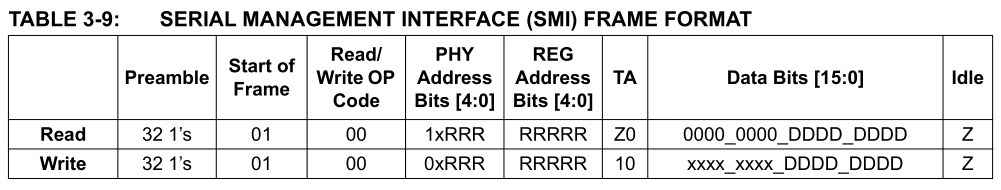

I am trying to use the KSZ8863 IC and (as shown in Table 3-9 of its datasheet) it has many configuration options behind a tweaked version of the standard MIIM interface. In particular, the opcode needs to be set to 00.
I have tried the following:
  • directly modify ETH->MACMDIOAR directly to set the PA and RDA bits as required by the KSZ8863 Table 3-9 (instead of HAL_ETH_ReadPHYRegister)

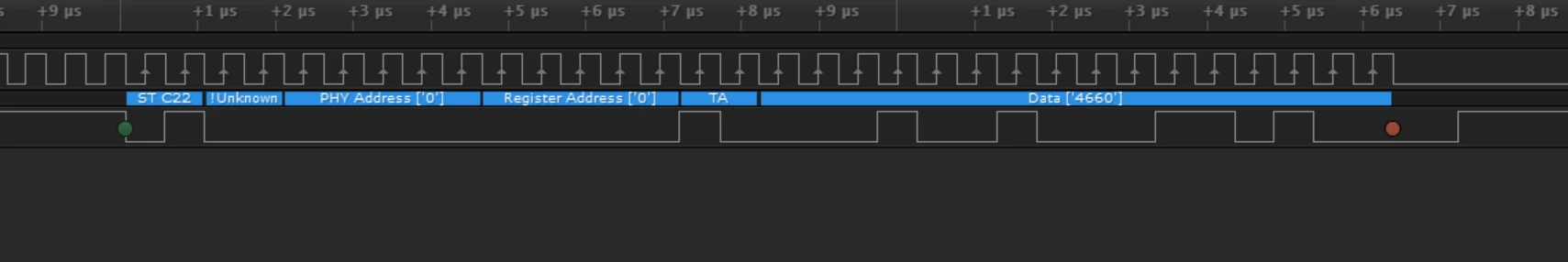

For any future users who stumble across this: I got a logic analyzer and it turns out that even though it is not "allowed" in the RM, it is possible to use the SMA peripheral to execute the custom "write" instruction:
To do this:
  • set ETH_MACMDIOAR_PA, ETH_MACMDIOAR_RDA as shown in the table ^
  • set ETH_MACMDIOAR_MOC to 0x0
  • set MACMDIODR to the (16 bits of) data you want to send
  • DO NOT SET the C45 bit
  • set ETH_MACMDIOAR_MB
This results in the following transmission on the wire: note that OP=00 despite it being listed as "reserved" in the RM, with the desired ST=01. I am just sending (bogus) data 0x1234 to register 0 as an example. EDIT: I have also verified that the write is accepted by the device.

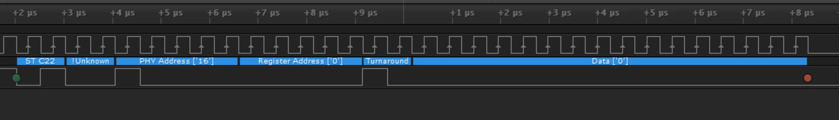

The bad news is that the custom read instruction does not work. Here is an example where I have done everything as in the write, but also cleared DR, and asserted the high bit of PA:
You can see that the everything till the turnaround is correct, but the data is 0. I assume this is because the STM32 is driving the MDIO line since it does not know that this is a read command, and the device (KSZ8863) cannot drive it.

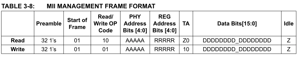

Except for the op code (which seems to suggest using the clause 45 bit), I notice that the protocol calls for "01" for the "start of frame" as shown in these tables (first regular MIIM, then the modified SMI)
However, it seems like the "start of frame" for clause 45 mode is 00 https://www.totalphase.com/support/articles/200349206-MDIO-Background
To do this:

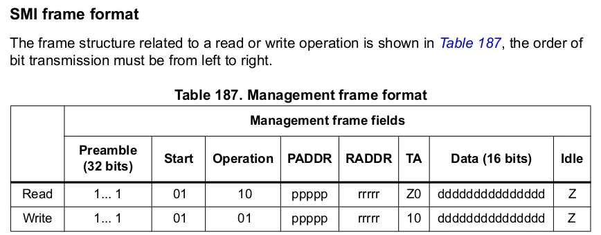

EDIT: from the Reference Manual, it seems the default for the SMI frame format is HI Z in the turnaround:
It seems plausible that the 10 in the operation being overwritten with 00 inhibits this HI Z default for the read operation.
