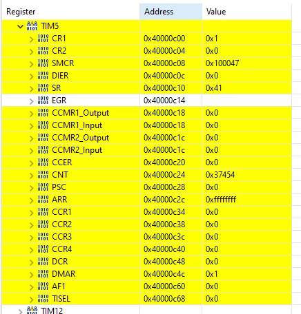

I have designed an audio device based on a STM32H743 MCU. For synchronization purposes I need to be able to count incoming USB frames.
To achieve this, I use TIM5 in slave mode, with ITR8 as its trigger.
The results are puzzling. I am getting either 1000 SOFs per second (as expected) - or 2000.
The behavior is specific to a particular MCU. I have 12 boards, all running the same code. Five count SOFs correctly and seven at twice the expected rate. Reflashing a MCU, even after a full chip erase, makes no difference.
The markings on all the processors are identical.
What might be going on? Any ideas?
Read out and post TIM5 registers content.

TIM5 registers attached. The values are identical in both sets of boards.
I have a ThreadX task, with a 50ms period loop. In each iteration, I read TIM5 CNT and compare it with the previous value. The results I am getting are either 50 (as expected) or 100.
