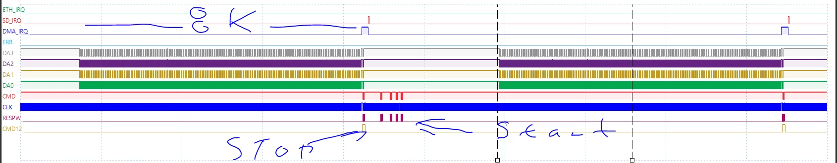

I’m currently working on code development for a new product based on STM32F769. At the moment I’m using STM32F769 Discovery kit as development hardware. I’m using FreeRTOS and FATFS. As data drive I use a standard SD card which is using SDMMC2 in SD 4 bits wide bus mode with a clock frequency of 24MHz. Transfer mode is DMA. I was able to manage through all the problems with DMA, CACHE, MMU and the code seemed to work quite stable. For testing, I’m using a test task which permanently reads a 140MB size file from the SD card (reading in 8kByte chunks). For better understanding I added a shot of successful card reading signals. Top three channels show some IRQs, ERR is indicating a timeout in SDMMC_GetCmdResp1, the signals on the SDCARD (D0-3,CMD,CLK), RESPW toggles while waiting in SDMMC_GetCmdResp1 (also when leaving) and CMD12 which indicates the stop command. (200us/diff)

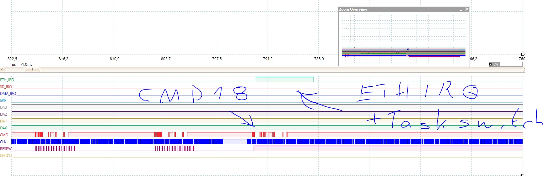

0693W00000Hq5XMQAZ.png1.)   After the ending of previous 8k read the next read multiple block command (CMD18) is sent to the card and wait for the response. Below picture show the zoom of the start.
While handling the CMD18 response an IRQ of the Ethernet is occurring. The toggling of RESPW stops although the response is not even received (in above zoom it is setting RESPW to high). Reason for that is that the Ethernet IRQ is serviced (is fine). However, with the IRQ the scheduler also seems do a task switch. The task for the SD card seems to get suspended.

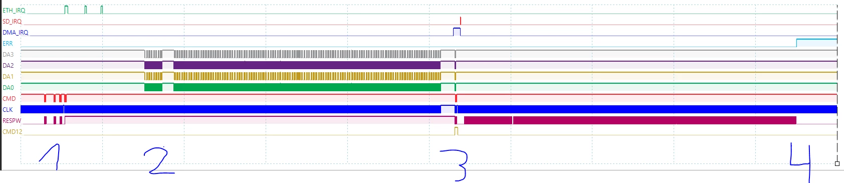

2.)   The data transfer starts and DMA is handling this. SD card task still seems to be suspended.
3.)   The data transfer is complete, DMA IRQ handles the stop command and overwrites by that the contents of the SDMMC_STA register. Short time after the SD_IRQ is handled the SD card task is getting back context and continues. However, as SDMMC_STA was modified by the DMA IRQ the SD card task never sees the result of sending the command.
4.)   SDMMC_GetCmdResp1 runs into timeout
