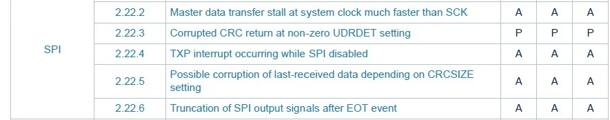

Hi Team,
Could you please confirm whether the following SPI erratum is considered in HAL version 1.11? I am currently using an MCU with revision V.

This below code snippet is from HAL and you can see that interrupts are disabled after the spi is disabled. Is this correct according to errata 2.22.4 ? The wrokaround says
"Keep TXP and TXC (the latter if the TSIZE field contains zero value) interrupt disabled whenever the SPI
peripheral is disabled"

@Saket_Om wrote:
Not every erratum is implemented within the HAL
This suggests that some errata are implemented within the HAL ?
PS:
I guess another problem with implementing errata workarounds in the HAL is that the HAL would then need to know the specific chip revision - to know whether or not the erratum applies.
mƎALLEm
Mar 16, 2026 1:02 PM UTC
In some cases yes.
Example:  the errata: 2.2.10 Reading from AXI SRAM may lead to data read corruption (from ES0392 - Rev 15) on STM32H7x3 rev Y:
The workaround was implemented in system_stm32h7xx.c:
 /* Change the switch matrix read issuing capability to 1 for the AXI SRAM target (Target 7) */
 if((DBGMCU->IDCODE & 0xFFFF0000U) < 0x20000000U)
 /* if stm32h7 revY*/
 *((__IO uint32_t*)0x51008108) = 0x00000001U;
