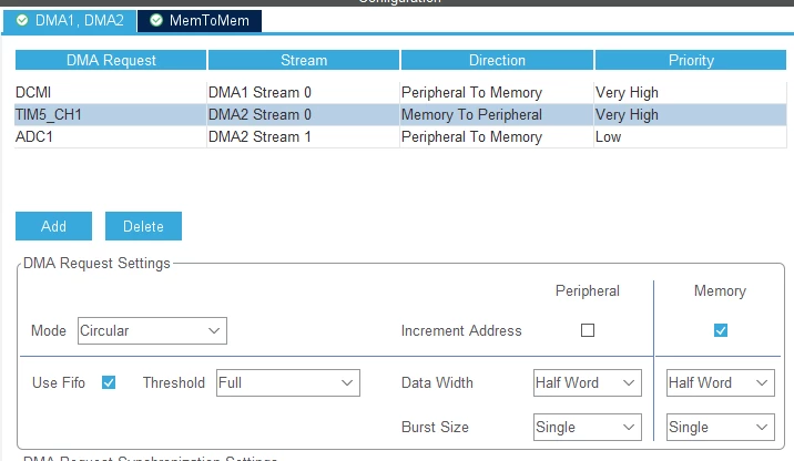

  • DCMI interface uses DMA1 Stream0 (very high priority, fifo), dma in double buffer mode. DMA moves data from DCMI to FMC external SDRAM. It generates two interrupt signal, half transfer complete and full transfer complete. When full transfer completed the transfer is restarted. With 30FPS I am getting half transfer and full transfer signals, so this seems like working properly.
  • When half transfer completed flag is set, the CPU runs a conversion function lets call ycrycbToRGB16() which converts the ycrycb video format to rgb 16bit format. This function finishes before the full transfer signal are set (<15ms execution time)
  • When full transfer completed, and ycrycbToRGB16() executed which is true, then we give a signal to external processor. It can start reading out the converted data, through the parallel interface (bus enable high). The parallel interface is implemented, at the STM32 side, with a timer capture input and full utilization of GPIO port B. The TIM5 input capture, captures the parallel bus clock signal and triggers a dma transfer (DMA2 Stream0, TIM5_CH1, fifo) to copy data from internal SDRAM to GPIOB port. When all data is read, the external processor signalize this on a GPIO input and goes to idle.
  • ADC capture is running in the background on two channels. Slow channels are used, clock operates on 10MHz maximum, 48ksps,scan conversion mode, DMA circular mode (DMA2 Stream1, the DMA transfer cycle is ~15kHz), this data is also send concatenated with the video capture data.

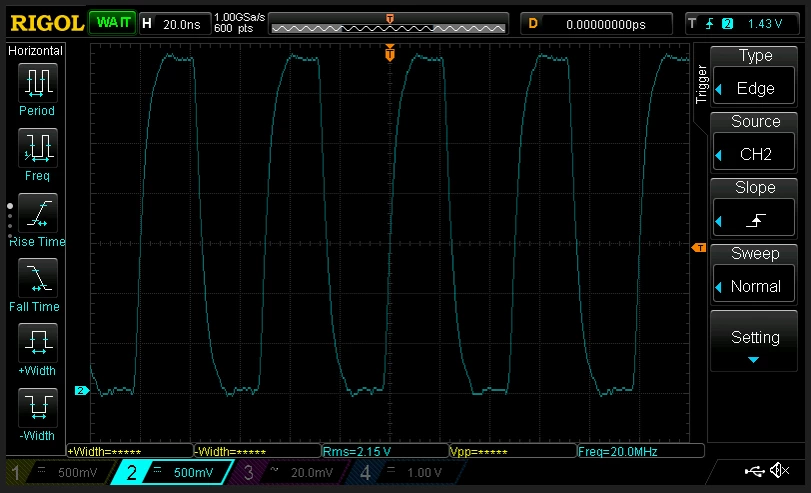

  3. If I increase the clock rate of the parallel bus, from 10MHz to 20MHz the timings are “crashed”. It seems stm32 is missing clocks from the external controller and therefore the data transmission breaks. The clock signal looks like this on the proto (with 20MHz clock):
All the parallel bus lines has a 120ohm series resistor now.

  1. Write code for MDMA or BDMA or DMAMUX or DMA2D controller for more advanced memory action. Especially considering a different domain rams+dma (D1, D2, D3)
  2. using mixed memory usage of D-CACHE + non cached sram. E.g. non cache for parallel bus data
  3. using d-cache but handling cases for sdram preparation before dma transfer e.g. clear/invalidate d-cache
  4. maximize the external SDRAM clock to 200MHz (as the SRAM maximum) and lower the SYSCLK
  5. using different memory layout e.g. smaller internal sram buffers for dcmi and writing data to external sdram with dma when the internal buffer is filled

Hardware / 20 MHz:
- the 120 Ohms seem a little high, maybe the flanks are not steep enough for some IO
- have you set all GPIOs to highest speed possible?

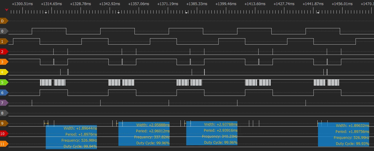

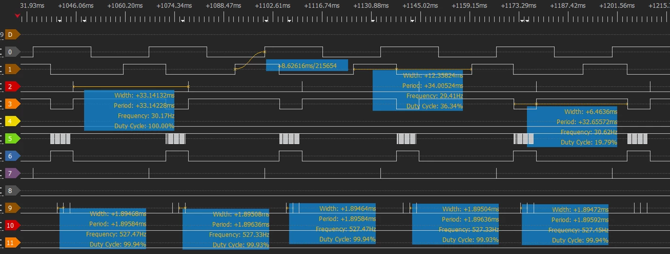

Seems like the issue is not related to the series resistor, but I replaced it to 10R. So here is the thing, I could manage to increase the parallel bus speed to 25MHz from 10Mhz, but it works only, if the audio capture is disabled. Without audio capture, the video stream runs smoothly. When I enable the audio capture, the DMA stream for parallel out is corrupted somehow... Both peripheral uses the DMA2 (Stream0 and Stream1). The DMA streams are configured as:
The TIM5_CH1 is the parallel interface clock input, it is configured for very high priority. The analog capture is on low priority. On the following picture you can see a "normal operation". CH9 is the interesting on, it shows the interrupt of the DMA2 Stream0, on CH5 you can see the parallel reading clock. Between two DMA interrupts we have ~1.895ms time.
And here it is the corrupted one:
The third transfer does not finish properly, and the last dma interrupt occours at ~2.95ms instead of 1.89ms. But the first arrived in time. And you can see the impulse train on the paralel clock are "doubled" in each reading cycle, because the MCU did not signalized the end of the parallel communication and so the external controller started a new reading cycle.
I checked plenty of things in the code already but I feel like I lost in the woods...It seems like the DMA2 Stream0 and Stream1 got into trouble somehow. Or there is some bandwidth issues on the internal buses. If I change back the paralell read speed to 10MHz then everything works properly.
Any idea to look for?

For series resistor, first I used 27R and I changed to 120R that I read from other forums. Basically from datasheet I saw 5pF input capacitance, so with 120R the cut frequency is pretty high still.

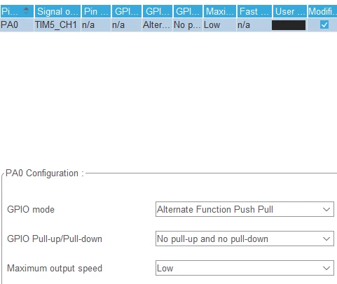

For all GPIOB the output speed is very high as they are configured as digital output. For clock input, I am not sure if I can set high speed for timer input. In GPIO config of cubeide I see this:
I do not know if it make sense to change the "Maximum output speed". The signal is input. Will check this.

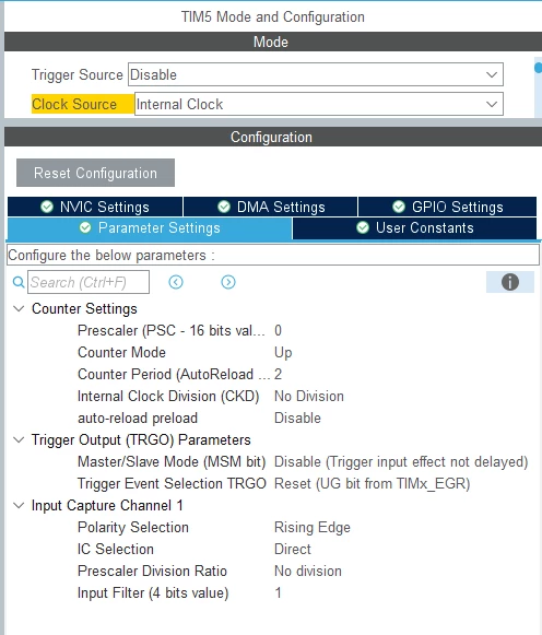

And I have this timer config:

Sep 2, 2024 2:27 PM UTC
The speed register settings only apply to outputs. But mind that the data lines to a memory are usually bi-directional.
120R: It's not only about the RC-lowpass corner frequency, this is also about flank steepness.
