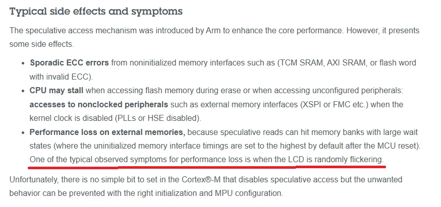

Hello ​@Mukeshkanna and welcome to the ST community,
1- Sorry I can’t open a link from google drive. Meanwhile LCD flickering could be due to a Cortex-M7 speculative access to a non valid external memory region. Please refer to this knowledge base article: Speculative access on Cortex®-M7 and Cortex®-M85 based STM32: A practical guide

I’m not LTDC interface expert. As I said please check your MPU configuration and disable the access to all unused memory regions.
That’s not related to the frame buffer cachability but (perhaps) to a speculative behavior of the Cortex-M7 to non valid memory regions. Did you read the article I shared?

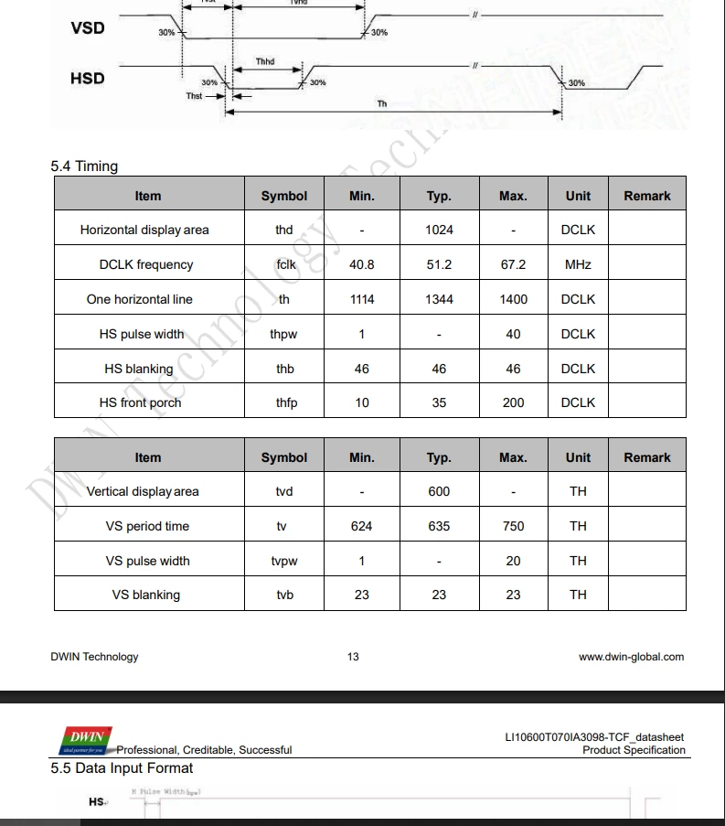

It's looking like you have selected high LTDC frequency in the clock configuration. And your LTDC parameters are not matching to that frequency.  Check yours display's data sheet and set LTDC parameters accordingly or try to reduce LTDC frequency.

i have gone through with your configuration file and compared these parameter with yours display datasheet.. yours Horizontal Timing looking correct. but in the Synchronization for Height section Total Height is 769  .. nut according to data sheet it should be in between 624~750 ….instead of VFP = 127 try VFP  =  12 or VFP = 1 that would give you Total Height = 655 or 644 that lies comfortably inside the datasheet limits.
and second thing is LTDC clock. according to the  datasheet your display supports Min :40.8 MHz, Typical : 51.2 MHz and Maximum 67.2 MHz . You should verify CubeMX is generating an LTDC clock inside this range.

  • We changed the Vertical Front Porch (VFP) to 12 and 1, bringing the Total Height within the datasheet-specified range. However, the display behavior remained unchanged, and the flickering issue still persists.
  • We also verified the LTDC clock and ensured that it is configured within the display datasheet's supported range (40.8 MHz to 67.2 MHz). This also did not result in any improvement.
  • Additionally, we enabled both CPU I-Cache and CPU D-Cache with the appropriate configuration. However, there was no noticeable change in the display flickering.
The flicker is still present and appears as a wave moving from the top of the display to the bottom. It is more noticeable with certain colors and less visible with others.
Please let us know if there are any other parameters or hardware-related checks that you would recommend.
