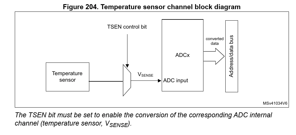

did you set Tsen ?
anasbaAuthor
May 6, 2024 9:18 AM UTC
Hello, thanks for the reply
Yes indeed I set the TSEN with the following :
ADC3_COMMON->CCR |= ADC_CCR_TSEN;
And then I run the calibration
anasbaAuthor
May 6, 2024 1:01 PM UTC
@AScha.3 It is still showing the same output even thought I enabled TSEN
HAL_ADCEx_Calibration_Start(&hadc3,ADC_CALIB_OFFSET_LINEARITY, ADC_SINGLE_ENDED);
Any ideas ?

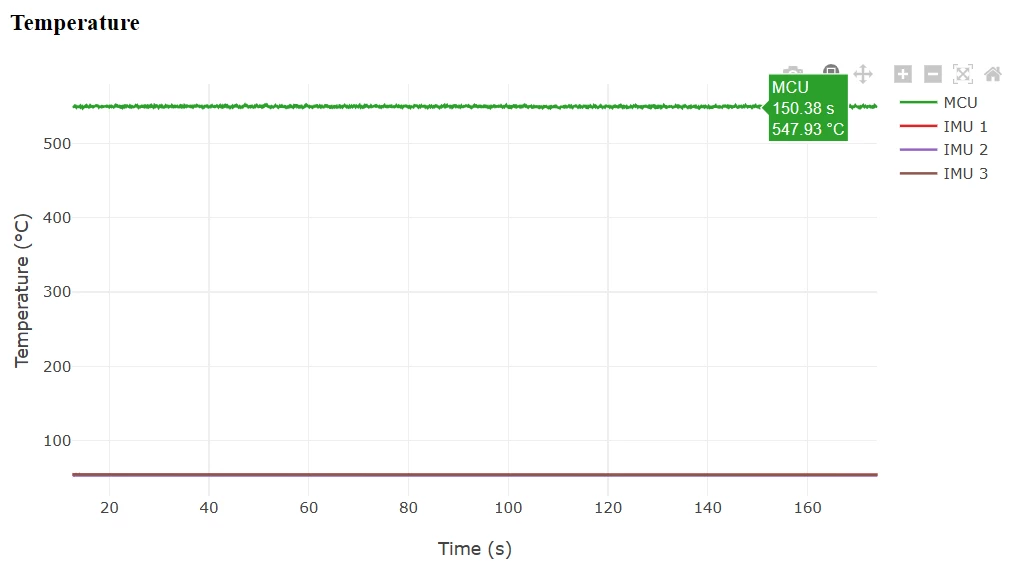

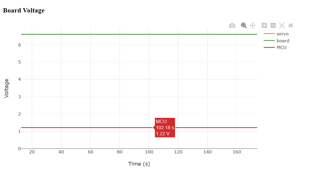

May 9, 2024 1:11 AM UTC
Hey,
I'm facing similar issue on H743VIT6. Internal temperature is almost 10 times. Even the 3.3V sensing is wrong. I'm using the H743VIT6 rev V.
