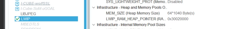

Hi everyone,
I own a nucleoH743ZI2 board trying to implement a Modbus TCP/IP protocol over a LwIP package. It's crucial for my application not to add FreeRTOS or any other OSs. The software used for the FW development and configuration is CubeIDE 1.13.1 and CubeMX 6.9.1.
There is a number of examples around the internet describing how to set correctly the project, some of them are not even coherent one to another. I'm aware I am missing some notions, some very low level ones about memory management and most likely those notions prevent me from solving my issue.
I successfully implemented the LwIP stack on the nucleo board, ping is performing correctly. Now I'm trying to operate the modbus protocol as well, the nucleo operates as server and I use my laptop with a dedicated SW tool as client. The connection and data exchange starts for a few seconds, then it goes directly in "Write error" and "Read error". The nucleo board can't be pinged from that moment on.
I believe it is a memory management wrongly configured. I guess the DMA might be pointng to the wrong address or something since it works for a few requests.
Have you encountered the same issue while implementing this peripheral? Maybe you have found some workaround that could be helpful. I've seen some old threads about it, but i expect the drivers to be well fixed as of today.
I'll attach what I believe are the three main files for this kind of debug.

Let me add a comment on why I think the issue is concerning the memory and DMA usage.
I tried multple times to enlarge the MEM_SIZE define, the more I enlarge it, the more time the communication stays on. Is it possibile it the DMA doesn't go back to the start of the RxBuffer?

Sep 20, 2023 8:19 AM UTC
Hi LCE,
thanks for your quick response. Let me start replying to the latest point. Being an H7 board, I'm using (depends on the attempt I'm trying) addresses in the range 0x30020000 up to 0x30040000, therefore SRAM 2 and 3, as I understand. They should be reasonable memory areas with a reasonable available space.
I have some questions on the memory allocation on your first reply though. CubeMX 6.9.1 does't allow to provide RxBuffer length:
For this reason I had to define in the ethernetif.c file the dedicated RxBufferLength (Rx_PoolSection in my case) and then allocate a share of SRAM memory to it in the linker script. I don't get the need to add the heap section which is aready defined in the LwIP section:
Is the usage of AXI RAM mandatory? I must say I don't know what the liker script you posted is doing with those instructions.
All of these configurations must be coherently aligned with the MPU, is that correct?
My first doubt is the .ioc configuration, if all the registers have been confgured correctly. That is the first thing I must make sure of. Secondly, the area memory.
