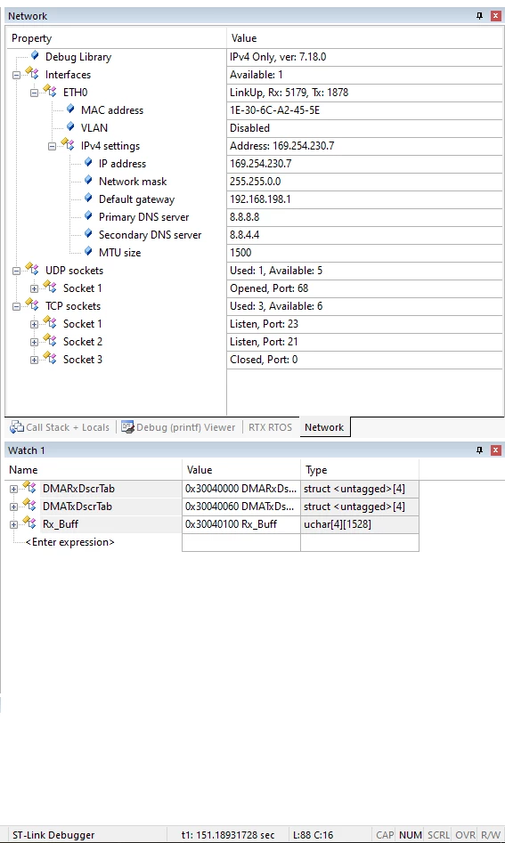

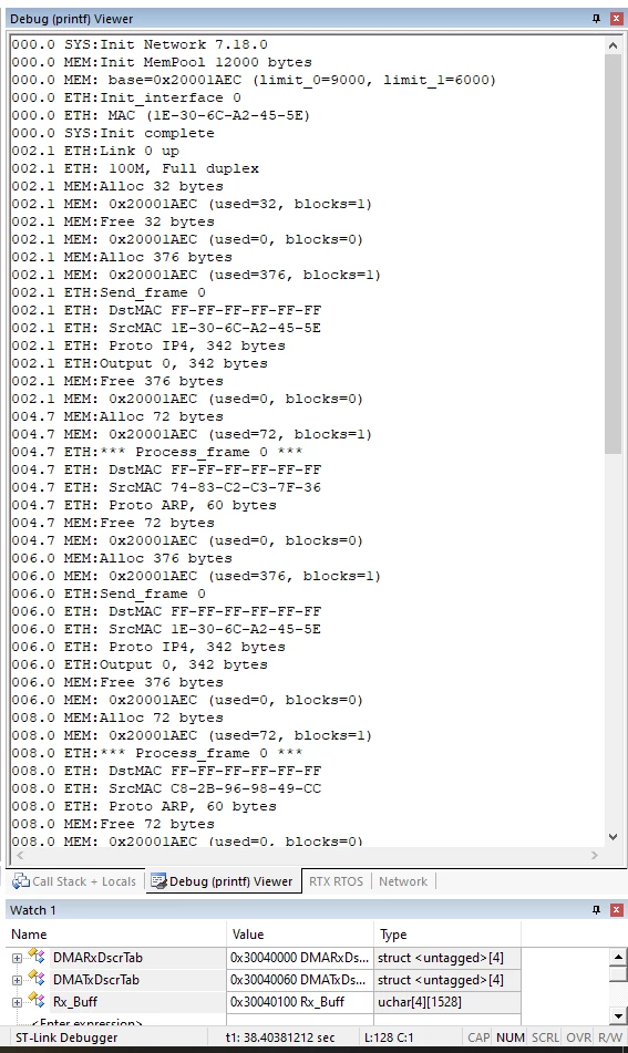

Got a problem with ethernet on my custom board with STM32H743BIT and DP83848 PHY
everything 'seems' to work, but I see no outgoing traffic from my board on wireshark.
Rx working though, screenshots attached.
I read an article
https://community.st.com/s/article/FAQ-Ethernet-not-working-on-STM32H7x3
but it didnt help.

If just the Tx is not working, it could be this issue:
https://community.st.com/s/question/0D53W00001oImr4SAC/bug-stm32-lwip-ethernet-driver-tx-deadlock
Or anything from my other topic, to which Imen gave the link already...

Well, it might be it. I switched to Oryx Cyclone stack and it works perfectly
