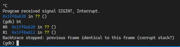

I can pretty much rule all those out. I know it's actually entering the bootloader (wire/button works fine), since I can break in in the debugger and see it running.
0693W00000BdZlEQAV.pngLikewise, I'm sure the cable is fine because USB works fine while running the application (ie, not bootloader). PC isn't ignoring it due to something previous, because I can power on the device, reset to DFU, then connect USB, and the behavior is the same. dmesg shows no new USB device.

I did a bit of reverse engineering with Ghidra + GDB, and there's a function with a big loop that checks, in sequence:
  • FD-CAN
  • I2C1-3
  • SPI1-4
  • Check if something is happening on the RX bit in GPIOB - USART1 alternate mapping (if so, switch the alternate function mapping for USART1 to PB14/15)
  • USART1-3
  • Check if a struct in RAM contains a particular value (USB :))
(curiously, this doesn't match the order of checks in AN2606 :o)
In the USB OTG interrupt, that same struct in RAM is set to contain the "cable present" value. But that condition is never happening, so USB isn't getting initialized for whatever reason.
