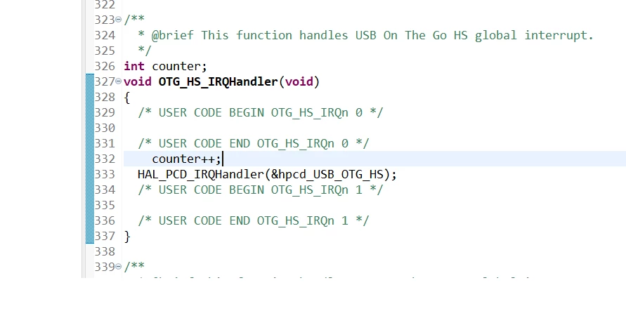

hello, my project uses USB CDC HS to communicate with PC.
Sometimes USB CDC HS work, sometime didnt (it depends on other variables of my project. and these variables doesnt relate to USB CDC HS, just any variable is added/removed).
MCU send data to CDC 30 message 42 byte per second
PC send 100 bytes to MCU when connect 1st time.
Picture 1: when USB CDC work normally.

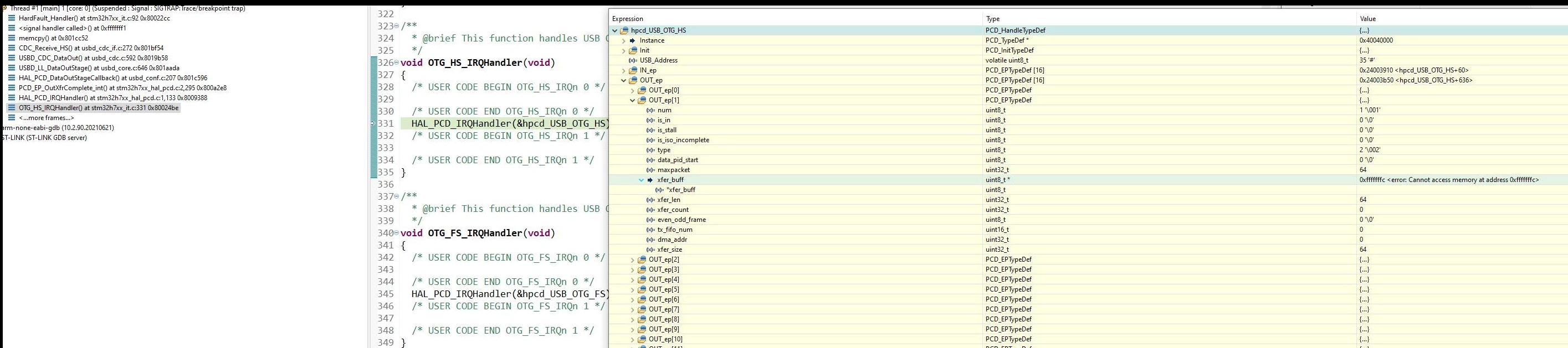

Picture 2: when hardware fault happens with hardware fault signal trace

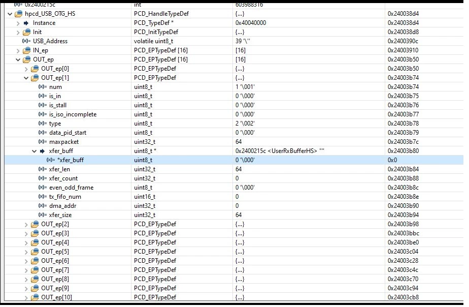

Picture 3: when hardware fault happens I just add any variable into OTG_HS_IRQHandler() and it works again.

Looks like a memory corruption, probably stack overflow. 0xfffffffc is a typical LR register value (link register), that gets pushed on the stack on every function/IRQ call. If you are running FreeRTOS or Azure try increasing the task stack sizes.

Use CubeIDE's fault analyzer, see where the code was when it hit that exception. Though I suspect that may not be too helpful. But worth a shot.

I just read UM1734 6.7 optimization foot print. tried to increase
void *USBD_static_malloc(uint32_t size)
 UNUSED(size);
 static uint32_t mem[(sizeof(USBD_CUSTOM_HID_HandleTypeDef) + sizeof(USBD_CDC_HandleTypeDef)/4+1)];/* On 32-bit boundary */
 return mem;
and it works again. Continue to use to see happen again. maybe I use both of CDC HS and HID FS need more memory. I continue to use and see :)
