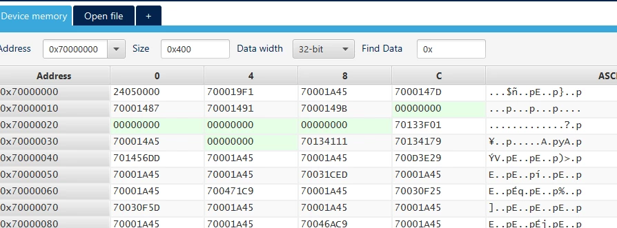

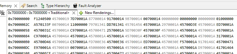

AJone.5Author
Feb 3, 2025 9:42 PM UTC
Thanks for your response Pavel,
For the curious, my investigation has moved along and I found that the value on the XSPI for the SP (and everything else) is different when read from the stand alone programmer:
Which, as we can see, has the right value for the SP
And what is read when using the bootloader debugger:
Which is wrong, and matches what my jump code sees when it accesses the XIP.
We are using the same External Loader in both cases, so it seems like something is off in my configuration of the XIP that causes the bootloader to read the address and get a garbled result.  Probably by skipping the first byte.
Have not found a smoking un yet, but not sure what else it could be.
Pavel A.
Feb 3, 2025 9:50 PM UTC
This means, your ext. flash initialization and/or XIP mode enablement does not work.
