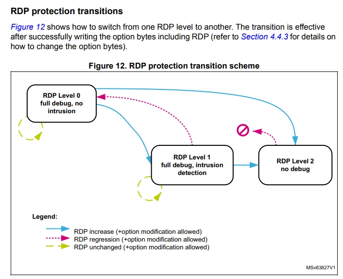

To be more precise, this is the code to set RDP to level 1:
  FLASH_OBProgramInitTypeDef OBInit;
  OPENBL_FLASH_OB_Unlock();
    HAL_FLASHEx_OBGetConfig(&OBInit);
    OBInit.OptionType = OPTIONBYTE_RDP;
    OBInit.RDPLevel   = RDPLevel;
    if (HAL_FLASHEx_OBProgram(&OBInit) != HAL_OK)
      OPENBL_FLASH_OB_Lock();
        return ERROR;
    // OPENBL_FLASH_OB_Lock();
    if (HAL_FLASH_OB_Launch() != HAL_OK)
      Error_Handler(); // This is not the cause of problem
      return ERROR;
With debugger, when the execution reaches “ HAL_FLASH_OB_Launch()”, the hardfault VECTTBL happened:
To rule out debugger causing an illegal flash access when rdp = 1, I repeated this execution after removing the debugger physically. After commanding the application to activate rdp = 1, it appears to stop responding. After  power off and on, rdp = 1 is successfully set and the device works normally.
According to the reference manual, a reset is not required. Therefore I would like to confirm if this behavior is expected or not.

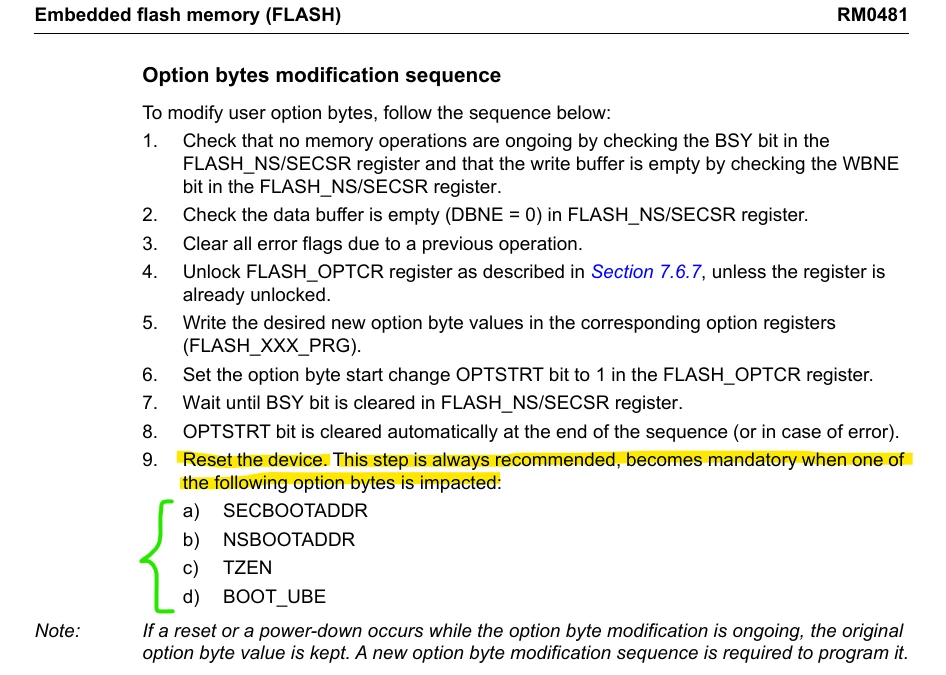

Aug 26, 2026 10:18 UTC
Hello ​@Zlzz
Thanks a lot for your pertinent questions.
According to RM0468, after a successful option-byte modification, the Flash interface automatically reloads all option bytes in order to update the current option-byte registers. Therefore, the reload mechanism is part of the normal behavior of a successful option-byte programming operation.
That said, the visible impact on execution may differ depending on the option-byte being modified.
In practice, some option-byte changes such as write protection may appear to complete with no obvious disruption to the running app, while security-related changes, such as RDP, may produce a more visible interruption of execution or debug connectivity.
So your observation is valid:
  • WRP programming may appear to execute normally
  • RDP programming may appear to stop execution or require a clean restart
Also, you are right that the current STM32H7 RM does not explicitly distinguish between:
  • option-byte changes that may require or strongly recommend a system reset/device restart
  • and other option-byte changes that may not require a reset from the app point of view
This clarification is not explicitly stated in the STM32H7 option-byte section, and this can make the behavior less clear for users.
For comparison, the documentation has already been enhanced on some other products, such as the STM32H5 family (Click here), where it is explicitly stated that the option-byte programming step resets the device, and that this step is always recommended and becomes mandatory when certain option bytes are modified not all of them, for example:
