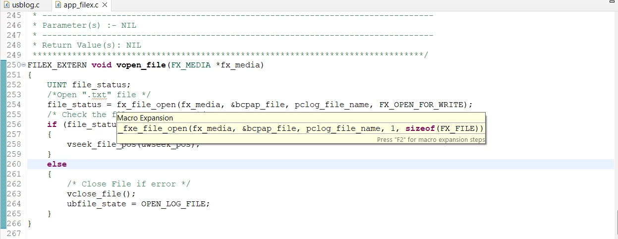

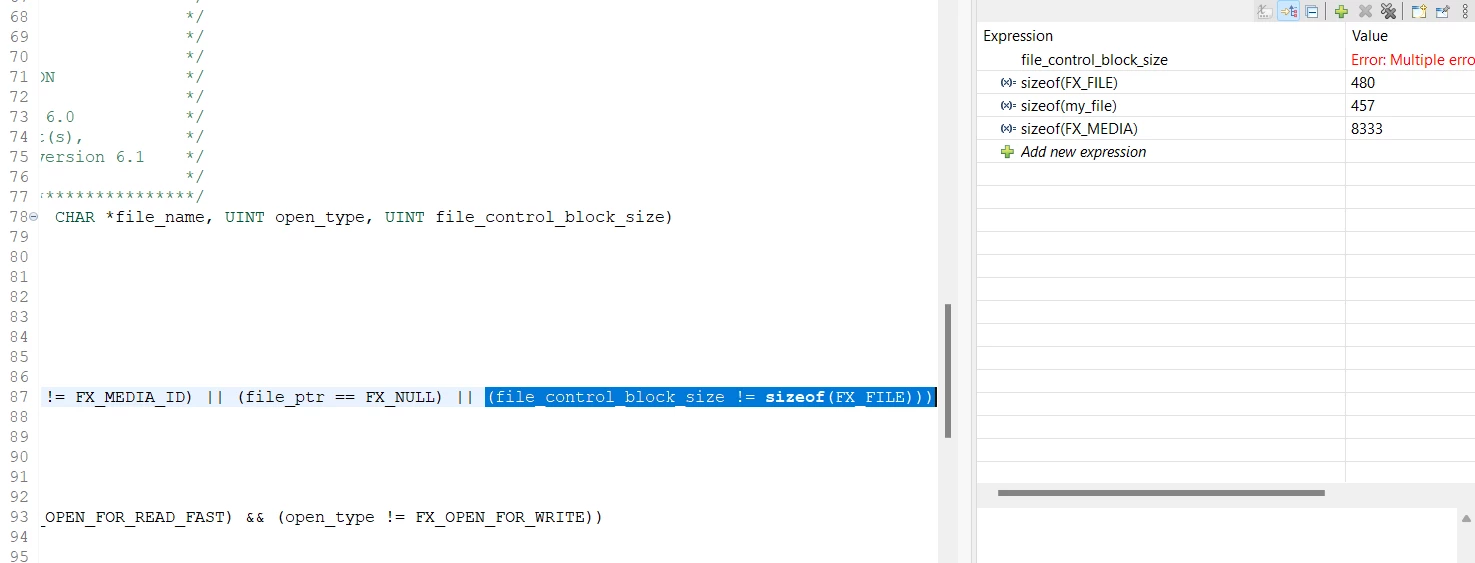

File created successfully, but not opened for write, because my code returns FX_PTR_ERROR due to the (file_control_block_size != sizeof(FX_FILE).
I got my file_control_block_size as 457 but sizeof(FX_FILE) is 480.
How get my file_control_block_size as 480, am i missing something.

Please find attached code used by myself for open file function mention below,
vopen_file(FX_MEDIA *fx_media)
UINT file_status;
/*Open ".txt" file */
FX_FILE bcpap_file;
file_status = fx_file_open(fx_media, &bcpap_file, pclog_file_name, FX_OPEN_FOR_WRITE);
/* Check the file open status */
if (file_status == FX_SUCCESS)
vseek_file_pos(uwseek_pos);
else
/* Close File if error */
vclose_file();
ubfile_state = OPEN_LOG_FILE;
I am creating new usblog.c and added vopen_file (mentioned below) where my code stuck duo to the my file_control_block_size and sizeof(FX_FILE) was not matched, while I'm copy and use the same function in app_filex.c then file_control_block_size and sizeof(FX_FILE) is matched with 480.
How, if we need to use fx_file_open function only at app_filex.c file?
