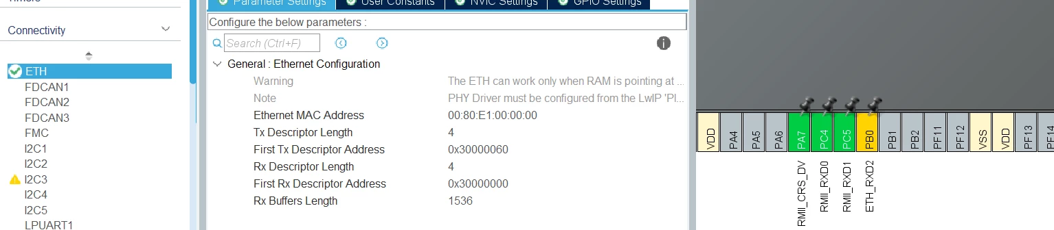

I tried initializing a simple lwIp project on cubeMx
Following the controllersTech's videos I :
  • enabled ETH (had to force PB0 to ETH_RXD2)
  • checked the size of the descriptors (96B => 0x60)
  • set the right memory address c.f. image 1 (0x3000 0000 for 1st descriptor [beginning of SRAM 1] 0x3000 0060 for second descripto)
  • enabled cortex7 data and instruction cache
  • enable lwIP
  • select LAN8742 in "platform settings"
  • keep the DHCP enabled (I also tried setting a static ip adress and it was inverted so now I keep the DHCP on)
  • set the heap size to 10KB and start it at 0x3000 4000 (SRAM2)
  • enable MPU
  • set base address at 0x3000 000 (SRAM1)
  • set the size to 32KB (SRAM 1 et 2)
  • set memory type to non-shareable device (c.f. youtube.com/watch?v=6IUfxSAFhlw) basicaly put TEX 1 disable everything the most important is that it's not cacheable
From there I can generate the project.
I add "extern struct netif gnetif;" in the main and "ethernetif_input(&gnetif);" and "sys_check_timeouts();" to the super loop (while(1)).
I should now be able to build and run my program and ping the IP address but when debugging it I instantly get a hardfault.

Hello. Thank you for your post because you helped me figure out my problems. I had the same issue on STM32H750VBT6 but solved.
You must pay attention to every detail because I had little mistakes that prevented my project from working. For example, one of my mistakes was configuring one of adreses missing one zero. Another time, I forgot to give all permissions in MPU according to the youtube video you provided. Another time I forgot to enable MPU to exclude the ethernet ram regions from cache. If it get cached, then the ethernet and LWIP software would not know if new data was written on the buffer by someone like the ethernet DMA. Another problem was signal integrity because I'm using an external module and wired with some clumsy board to board wires with poor shilding and grounding. That RMII digital signal is 50MHz by the way! But it worked after I cut those wires short enough. Now I'm using 10cm board to board wires again with no shilding and proper transmission line impedance control (line impedance, impedance matching, termination). It is a good idea to check if the communication with LAN8742 using that MDIO is ok. I'm not an exert but I think it serves as an auxiliary communication for configuration and some other perposes. You can check if Link is Up and speed is 10 or 100MB/s using the code I provide you in the end. Pay attention is some LWIP software package versions, the name "RxArraySection" is different. for me it is "Rx_PoolSection". My flash linker code in the sections part is as follows:
.lwip_sec (NOLOAD) :
. = ABSOLUTE(0x30000000);
*(.RxDecripSection)
. = ABSOLUTE(0x30000080);
*(.TxDecripSection)
. = ABSOLUTE(0x30000100);
*(.Rx_PoolSection)
} >RAM_D2
My last problem was that I thought it is not neccessary to read the buffer by my self manually for only ICMP (ping) protocol. But it seems like to be mandatory. You should check the buffer frequently using the code provided in that video you addressed:
finally if everything is ok you can use the command "arp -a" in a command window in windows to see if your device is visible in the ip map of your local network. Also I suggest you not to use DHCP in the beginning. Use a static IP first and then move on to DHCP. I also set the MPU for ethernet region as sharable. I don't know if it has any effect.
Another problem I was facing was that the first time after MCU boot or reset, it would transmit an ARP packet to my laptop and it would appear in the list but ping did not respond at all. I mean you should check ping and do not rely on arp command alone because I think somewhere in LWIP or ethernet interrupt routine,  some flags were not cleared properly. It only interrupted one time. I also checked if you do not read the buffer frequently this probelm would happen. I connected the LAN8742 directly to my laptop using static IP. Another problem you might face is windows firewall. As of my last attempt, windows 11 does not let you easily change the type of this direct ethernet network to a secure one and always count it as public unsafe and firewall rules apply. There are various solutions available but simplest is to disable firewall or configure special rule for the specific static IP adress of your device. It is a good practice to check your ethernet packets using wireshark.
